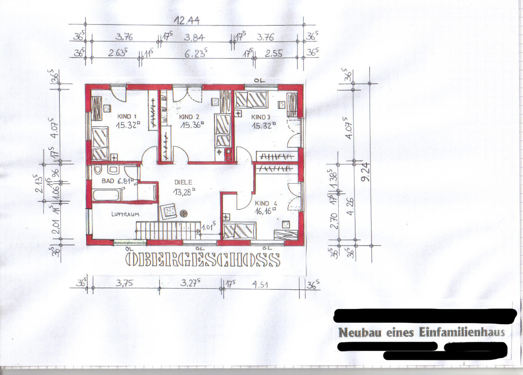

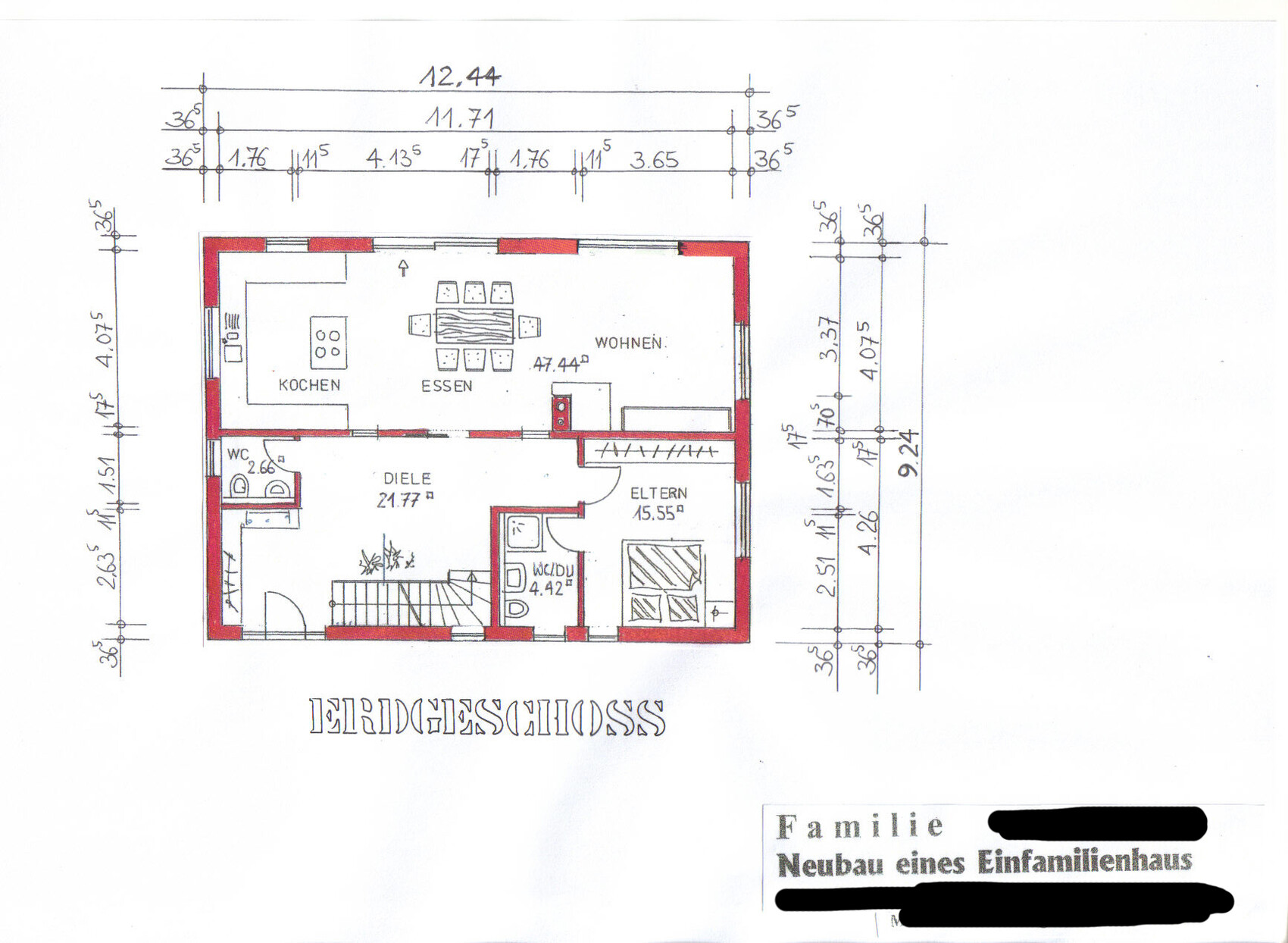

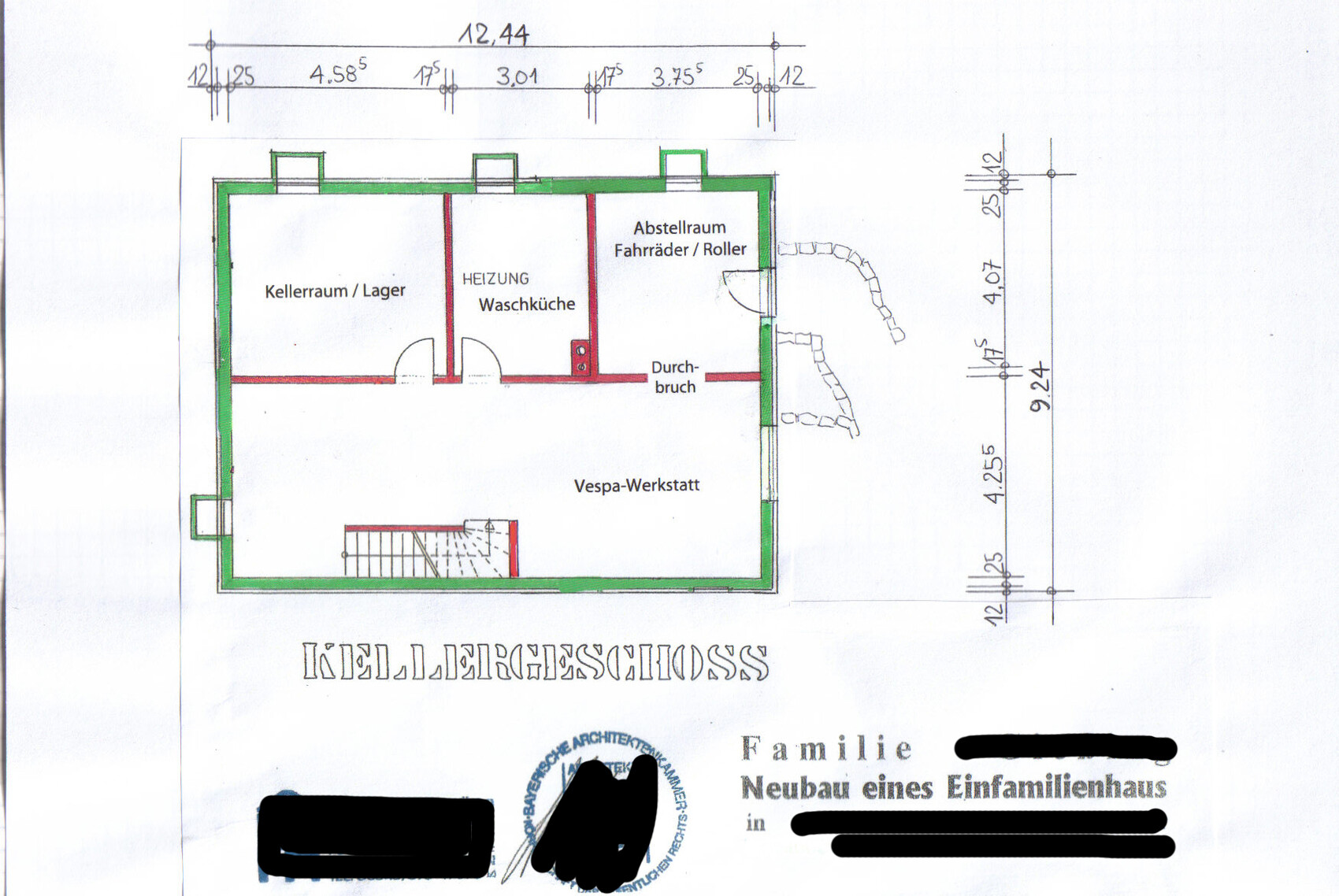

Now about our planning and the attached floor plan:
We have assessed our budget and found that we can realize our “dream home” – a house that fits our current needs and ideal ideas regarding room layout and size. This is a very positive thought, and we are very happy about it. We have designed a house that we need NOW and for the next 20 years – for the prime of our life! How we will use the four children’s rooms upstairs if the children move out later is unknown and honestly not important right now.
The floor plan focuses largely on a bright living space for the family. The children should also have spaces to retreat, and we want to place a large dining table. Additionally, we want a generous entrance area. I also need a small office space for my hobby (photography) with a computer desk, which we plan to locate in the “hall” on the upper floor (= corner desk where a chair is currently shown).
Many aspects have ultimately been subordinated to these requirements, and we are very satisfied with the attached floor plan.

Ground floor plan of a single-family house with kitchen, dining, living, hall, master bedroom.
Basement floor: cellar/storage, heating/laundry room, storage room for bicycles/scooters, Vespa workshop
Upper floor plan: 4 children’s rooms, bathroom, hall, open space, and staircase

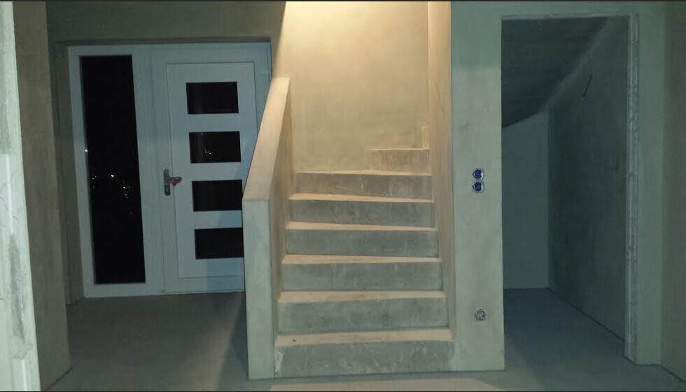

We also have a fairly large hallway, which many might consider wasteful. And the result? We love it, and our visitors are impressed. Sometimes you have to trust your instincts, and that’s a good thing.

We also have a fairly large hallway, which quite a few would consider wasteful
How would that translate numerically?
EveundGerd1 Feb 2016 22:32
Not just translate the numbers. Take a photo and upload the picture.
We saw an entrance similar to BeHaElJa’s in a Fingerhaus medley. We liked it a lot. I still do!
However, it didn’t fit our floor plan. So, we have a straight staircase that makes a left turn near the top. Friendly for a stairlift, of course.

Would you give up the open space in the upper floor to enlarge the children’s bathroom? In my opinion, the hallway is really quite large, while the main family area feels too small. 47 sqm (505 sq ft) for 6 people is definitely tight. Especially since children like to play near their parents when they are still small.
Later on, homework is often done at the dining table.
At least during primary school, and later happily together with siblings...
I recommend reducing the size of the hallway and installing a different staircase. Especially near the stairs, I noticed it’s almost possible to trip on the bottom step as soon as you enter through the door.
A staircase with a landing between two straight flights and a window front would be nice. That would make it feel more open.
The guest toilet could be expanded to include another shower. There will come a day when 5-6 people need to leave the house in a short time window. At that point, you’ll be grateful for the extra option.
Best regards from Eve, whose main living area is 46 sqm (495 sq ft).
Hello, thanks for your effort!
Well, as I said, I really like Patrick’s design by now. I just need to let it sink in and think it over. As mentioned, our current apartment doesn’t have much more total living space than our future living room! So it’s hard for me to consider that too small... I hadn’t thought about the morning time crunch yet! Thanks!

The external dimensions are 14 x 10.40 m (46 x 34 ft) and 14 x 8.74 m (46 x 29 ft).
The passageway is 1.15 m (45 inches) wide – I had the same concern that it might feel too narrow, but it feels right. We haven’t moved in yet.
Looks great! What is the stair rise height?

18.5 cm (7.3 inches) rise and 27 cm (10.6 inches) going (I think, or 27.5 cm / 10.8 inches).
16 steps for a ceiling height of 2.6 m (8.5 feet) from the finished floor.
