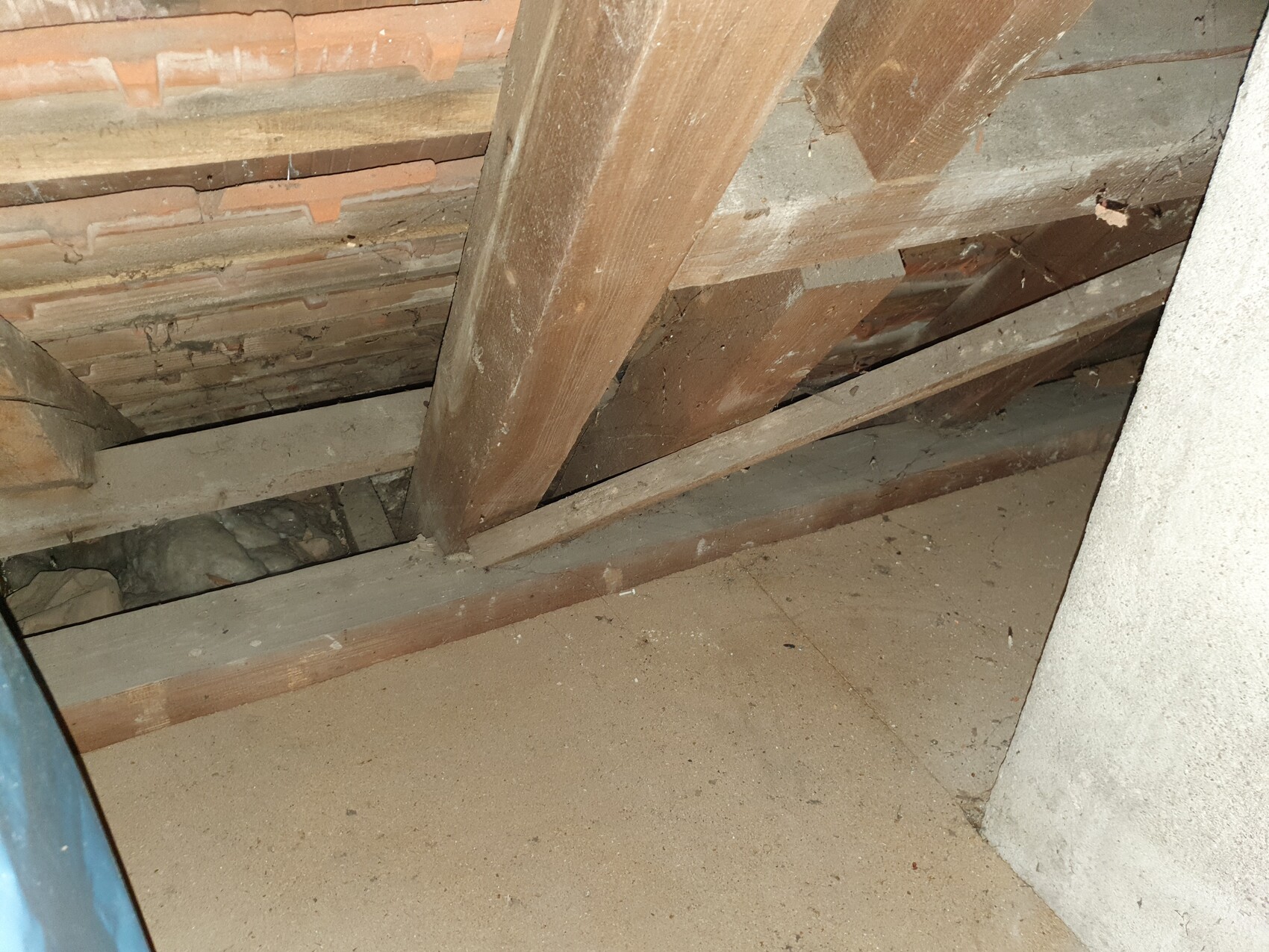

hanghaus2000 schrieb:
What does the roof structure look like?
[...] Is the ceiling above the ground floor made of concrete?Based on the construction year and type, I do not expect the ceiling here to be made of concrete. In this particular case, I am especially concerned that the issue might be that the ceiling and roof structure are not separated.https://www.instagram.com/11antgmxde/
Schallinger25 Jul 2021 12:54I assume it is a wooden ceiling. If the ceiling and roof structure are connected, does that mean that the roof cannot be altered or renovated without at least partially removing the ceiling? Am I understanding this correctly? Setting that aside, raising the building by 1 meter (3 feet) would be difficult. As a result, the rooms on the first floor would actually remain too small, which would again lead us to consider an extension. Nevertheless, the roof and knee wall would remain uninsulated and would still need to be addressed. I feel like I’m going in circles. There is no building permit / planning permission in this area.
Schallinger schrieb:
I assume it is a wooden ceiling. If the ceiling and roof structure are connected, does that mean the roof cannot be altered or renovated without at least partially removing the ceiling? Am I understanding this correctly? That is roughly correct—I suspect the elements are not structurally separate.
Your photo is pretty much useless without indicating what exactly and from which angle it shows.
Clarification is absolutely essential for any remodeling project.
Apart from the fact that adding an extra meter (3 feet) would be difficult. Well, just tricky fiddling.
