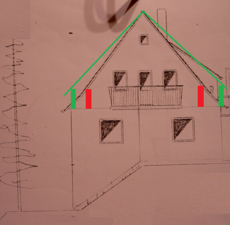

Has anyone done something like this? Removing the roofing, dismantling the roof structure (removing the knee wall), building up the exterior walls by about 1 meter (3 ft 3 in), and constructing a new roof with proper insulation? Is this reasonable for a 60-year-old house if the overall condition is solid? What structural issues might arise due to the knee wall or the new exterior wall? What challenges could occur during the process? What are typical cost ranges? (Yes, I know it varies widely across Germany, but is it more likely around 80,000 or 150,000 euros?)
Attached is a side view (sketches not to scale but roughly approximate to illustrate my question; red = current “knee wall,” green = extended masonry wall and new roof). Thank you very much and have a nice Saturday.

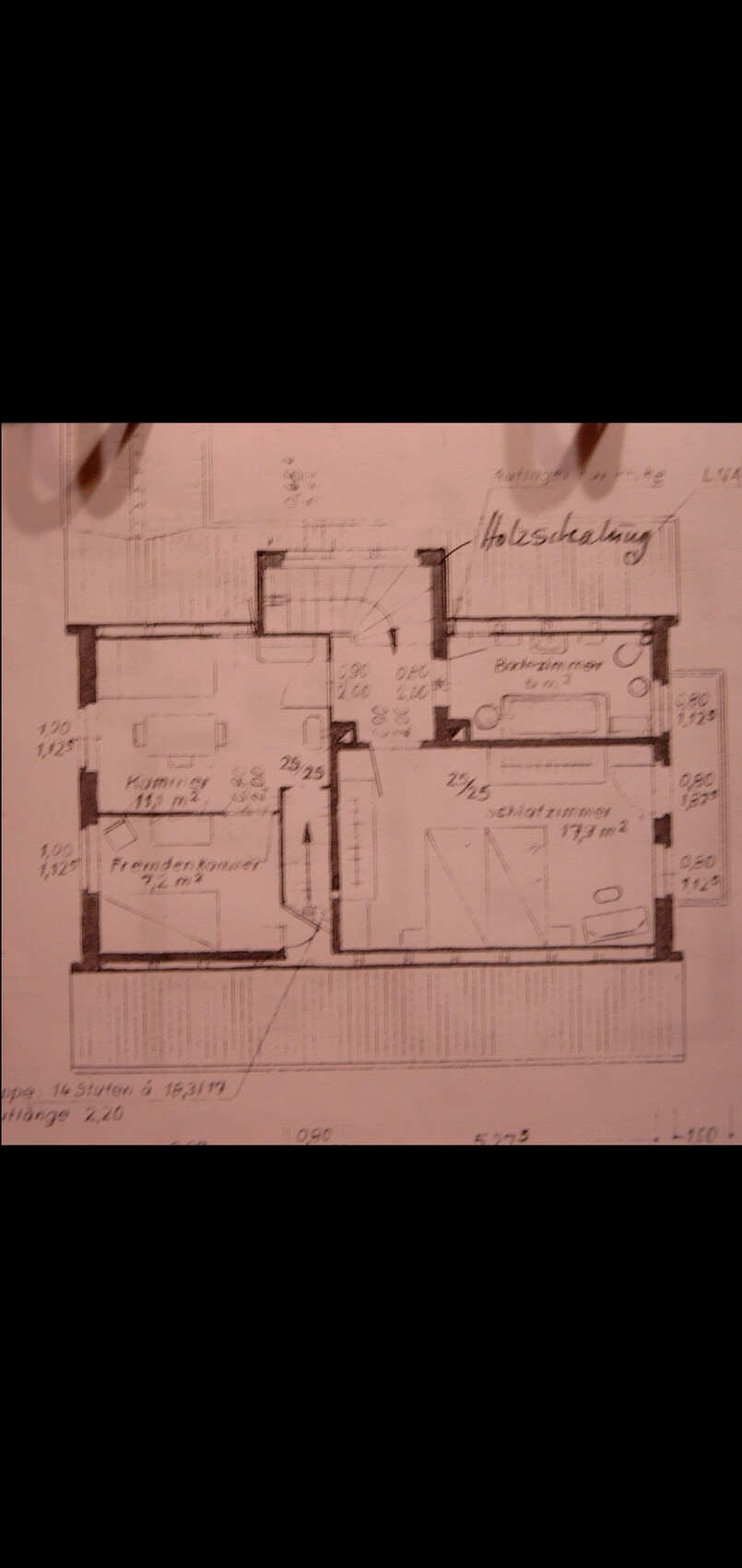

I hoped you would be smart enough to upload more drawings from the building file here right away. As I mentioned earlier, I fear the delays indicate that the operation is more complicated than you imagine.

That quickly leads you to a two-story design. I don't really see it that way here. My concerns are more about the economically "reasonable" feasibility.
