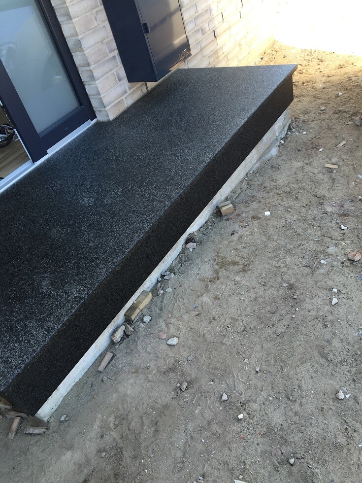

hausprofi19 Feb 2017 07:58Thank you for the pictures – it looks very good. I think I will do it the same way.
We had this made from a single granite slab. The picture actually looks quite good, and at 30€ definitely unbeatable value.
Here is our entrance platform.
Unfortunately, I don’t have a nice recent photo showing the finished paved walkway yet.
The entrance platform, including groundworks, a thick foundation, installation of the slab, and edging, cost 2500€.
