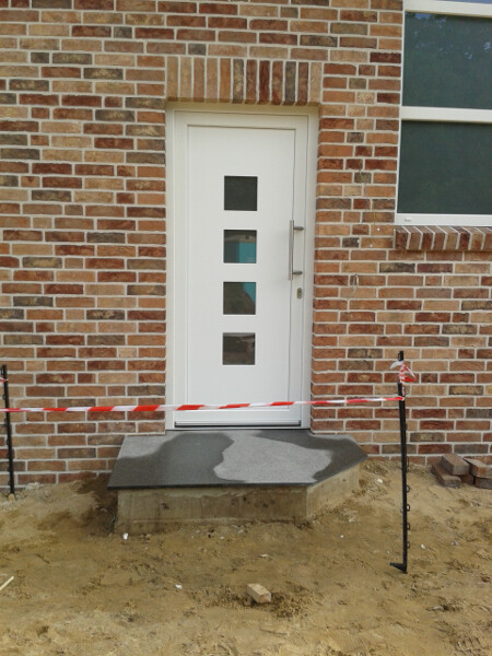

hausprofi15 Feb 2017 22:34I am from the Cologne/Bonn area. The natural stone is from Zimbabwe, not Norway. The stonemason labor costs really add up as well...
hausprofi16 Feb 2017 12:12Cool – please upload a picture.
Yesterday, I saw a variation where the edges of the landing are set similarly to curbstones in hydraulic lime mortar. Then, the void is filled with gravel and aggregate, and the step tread and landing slab are placed on top. You could possibly apply a bit of hydraulic lime mortar on the aggregate layer in some spots. The question remains whether this will be stable. However, I would definitely recommend laying a strip foundation on the compacted gravel base for the edging stones to ensure they are level (or with a 1% slope).

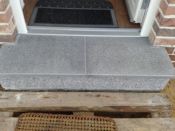

hausprofi16 Feb 2017 13:54For the side entrance door, we chose a more economical solution. My dad first poured a concrete base here as well, but instead of having an expensive granite slab custom made, we bought two granite patio slabs from a home improvement store that are almost the same color as the large granite slab at the front door. For the risers, we simply used granite lawn edging stones.
The total cost of materials was under 30€ and it still looks quite good and serves its purpose well.
