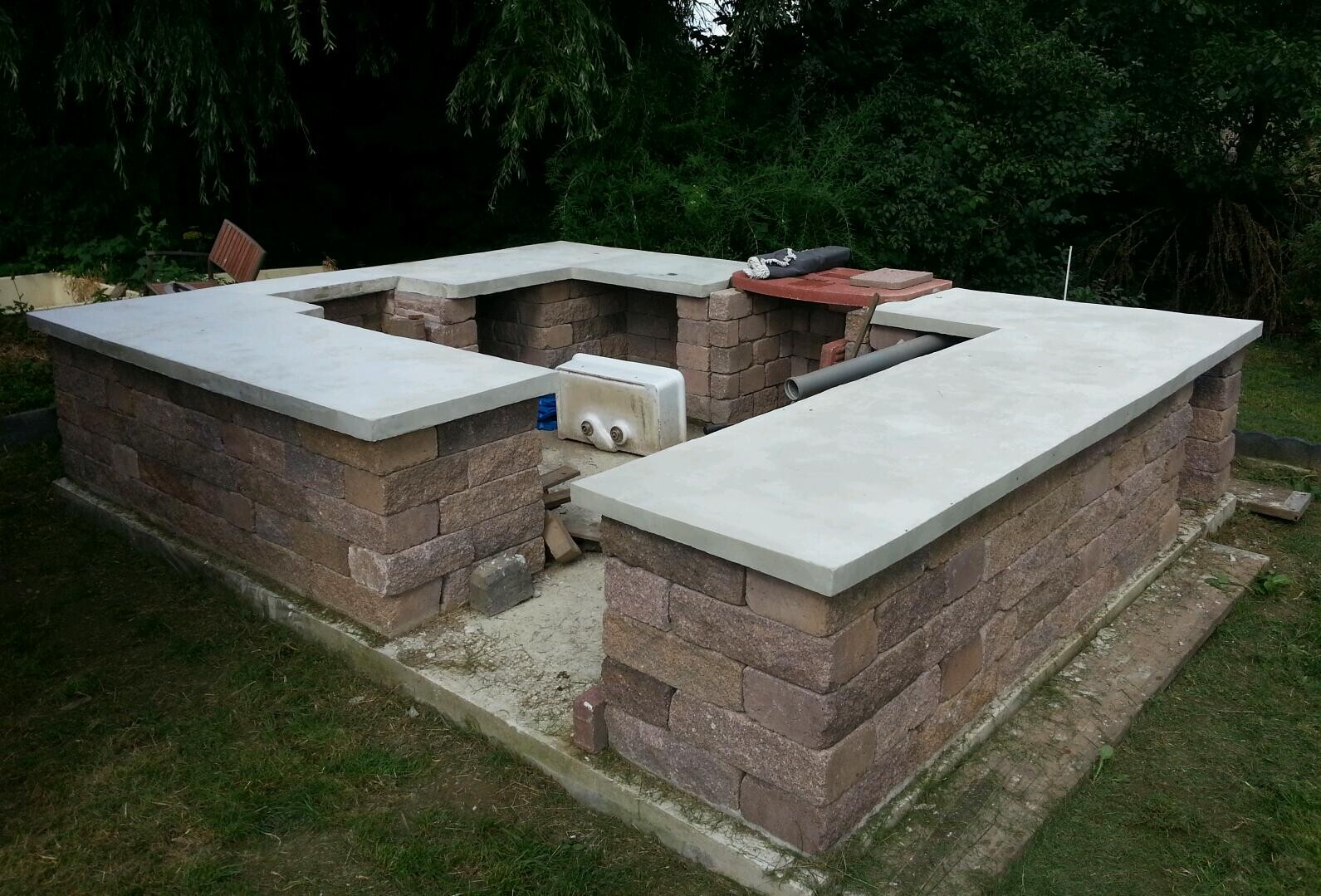

I’m currently building an outdoor kitchen. For this, I poured a concrete slab, then laid masonry blocks, and finally made a countertop. For the countertop, I first built the formwork, lined it with a plastic sheet, placed reinforcement bars inside, and poured ready-mixed concrete. I tamped the concrete as best as I could, with varying success. After one week, I removed the formwork and covered the surface with plastic due to rain. You can see the result in the picture. That was almost two weeks ago now.
