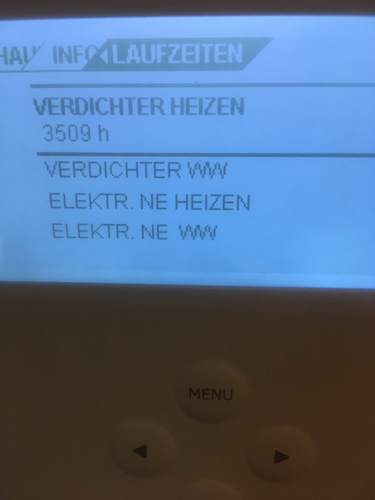

I have your system and can tell you that during the handover, the HVAC technician asked me how I wanted the system to be set in case of a malfunction (a malfunction that does not resolve itself and persists) for both domestic hot water and underfloor heating. Specifically, in the event of a heat pump failure:
- No support from the electric backup heater for water and underfloor heating (everything stays cold)
- Support from the electric backup heater for water only, not underfloor heating (only hot water, underfloor heating stays cold)
- Support from the electric backup heater for underfloor heating only, not water (the opposite)
- And then there is the tricky option where the electric backup heater activates for both in case of a malfunction.
That means the electric backup heater runs continuously until you notice it, which usually doesn’t happen as everything appears to be working fine.
I would have had to sign off on this option with the technician.
Check your menu and try switching off the electric backup heater operation!
