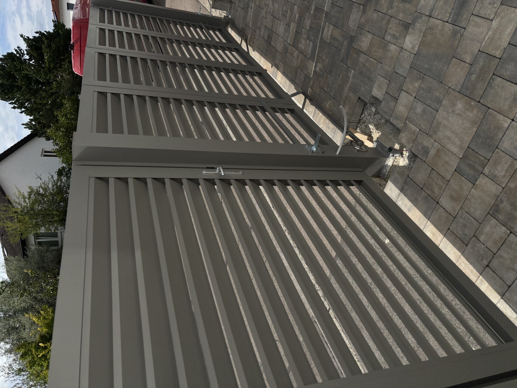

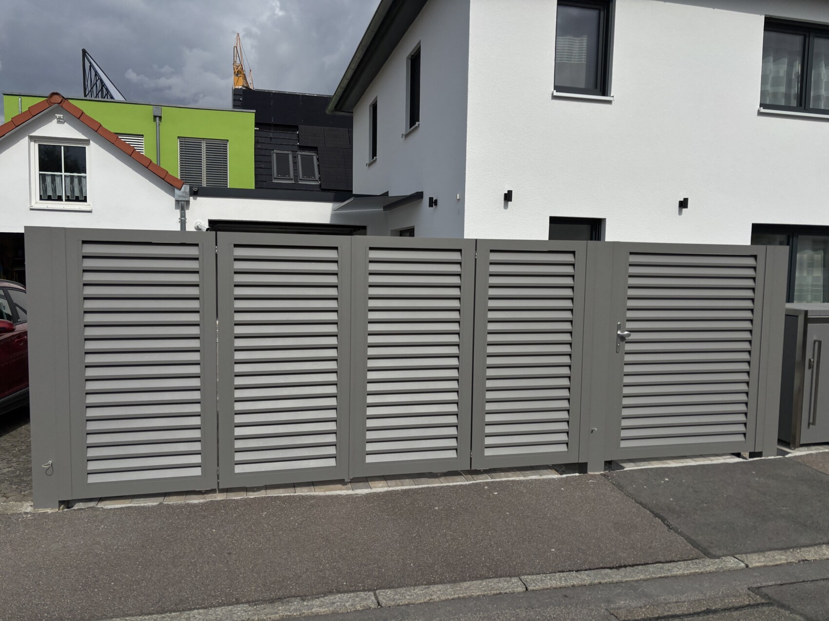

Allthewayup18 Jun 2025 21:27K a t j a schrieb:
Wow, that's quite a lot of money for a 13m (43 feet) enclosure. Is it so tight there that you need such an expensive gate? Unfortunately, yes. I would have preferred more affordable options, but given the circumstances, a folding gate with four leaves was unavoidable. And since it also needs to look good, it turned out to be quite expensive.
