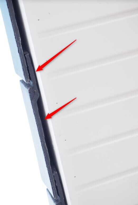

Are there any guidelines on how large this gap should be to ensure the wood is sufficiently protected from moisture?
Currently, in our case, it is about 0.5cm (0.2 inches).
Close-up of a white, ribbed door leaf with a blue edge; gaps visible
My research has been somewhat successful so far, but maybe this is due to using the wrong search terms.

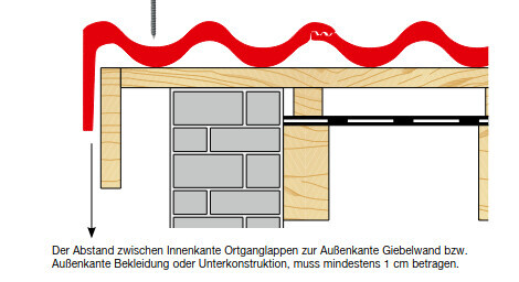

WilderSueden
10 Sep 2023 23:14
For this, you should refer to the installation instructions provided by the manufacturer. For example, this is how it looks for the Sigma roof tiles used on my garden shed and carport.
Schematic cross-section of an exterior wall with insulation, wood, and stone structures
Personally, I think 0.5cm (0.2 inches) would be generally too tight.

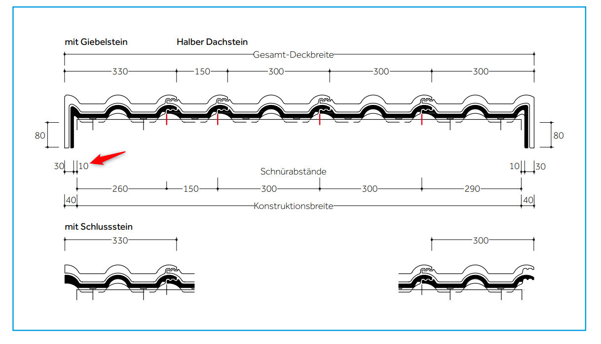

chrimu27
10 Sep 2023 23:21
Thank you! We are using Frankfurter tiles from Braas.
In the manual on page 13, there is this illustration – I would interpret it as specifying a 1cm (0.4 inch) gap here, right?
Technische Zeichnung eines Dachziegel-Profils mit Maßen, Abständen und Deckbreiten.
WilderSueden
11 Sep 2023 19:11
I would interpret it the same way.
However, I don’t think anyone will reroof your house just because of that.
