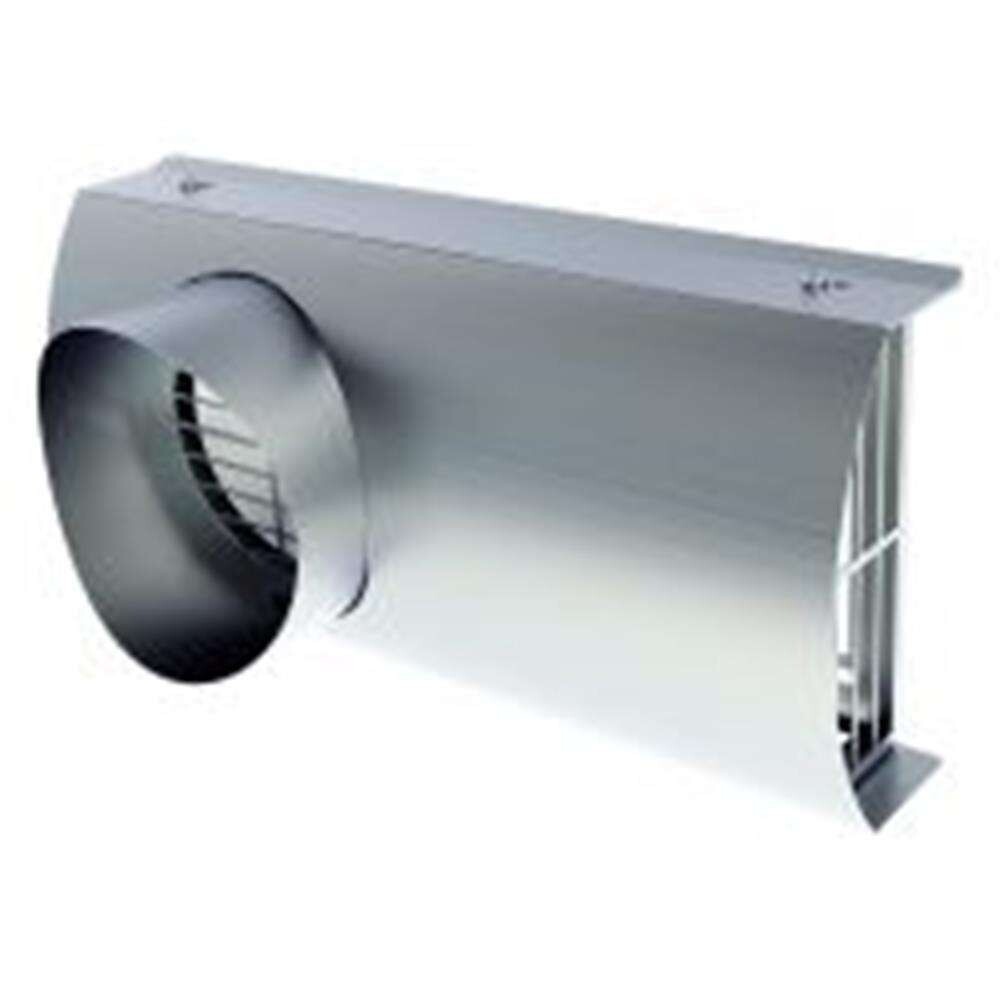

Question for the professionals:
-New build KfW55 standard
-Central ventilation system
The specialist company has only maintained a 2-meter (6.6 feet) distance between the exhaust air and the fresh air intakes, arranged vertically in a line (see pictures). Fresh air on top, exhaust air below.
This setup is on the west side. Now, I and several other contractors are concerned that there might be air short-circuiting occurring. The specialist company has no concerns at all and sees no alternative option (due to dew points, etc.).
Unfortunately, this issue was not properly considered during the shell construction planning by the plumbing company.
Maybe someone has an alternative solution or idea? Or perhaps no concern at all because they have installed a similar system like this multiple times?
The idea of underground routing was rejected due to condensation risks (according to the specialist company). The idea to locate it on the other side of the exterior door was also dismissed (which would also only be about 2 meters (6.6 feet) apart).
Our equipment room is very limited in space, and the west side is the only exterior wall. Do you need any further information?
Looking forward to your opinion, advice, or solution!
