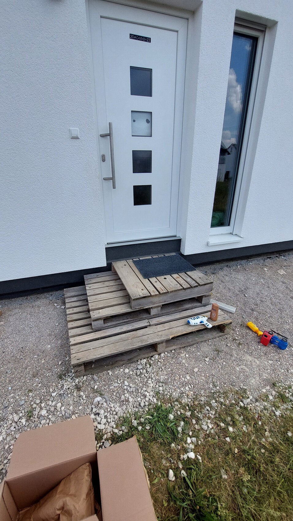

we have built a prefabricated house using timber frame construction. Now it’s time to work on the entrance platform. Due to the parking area in front, we need to build a three-step staircase along the house wall instead of directly in front of the entrance door. The house manufacturer refers to DIN 68000-2 for splash water protection. This standard requires a grate between the entrance platform and the door. If I understand correctly, the adjacent steps must be installed with a 30cm (12 inches) gap from the basement wall as a drip strip.
This means the entire staircase would have a 30cm (12 inches) gap from the wall, which doesn’t look very appealing. At the top, there would be the grate in front of the door, which would look like a kind of bridge.
Do the professionals interpret DIN 68000-2 the same way? And if so, what would be the procedure if the entire staircase is covered with a canopy? Would it then be possible to omit the grate and drip strip?
The photo shows the approximate staircase design.
Thank you very much for your tips and opinions.
Regards
Manuel
