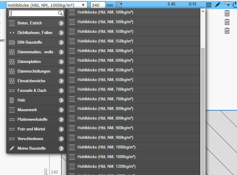

Fragehiersel12 Apr 2023 11:04What should I enter in ubakus for 3.)? Many construction materials are not unlocked in the demo version.
