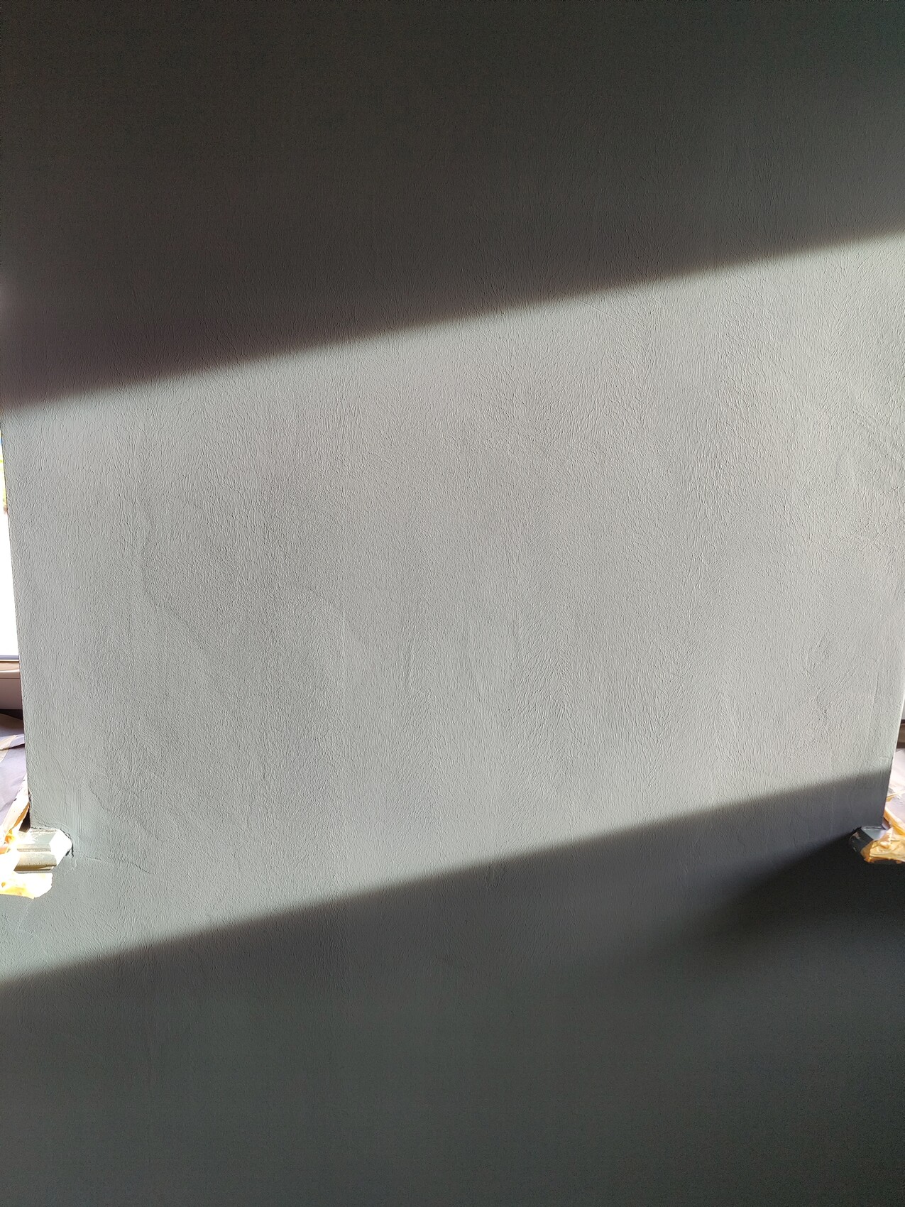

after a long time, I am back with a less pleasant topic. The order was Q4 finish and painting with clay paint.
The following issues:
1. Even without (natural) grazing light, the walls are clearly not perfectly smooth. I can basically accept that, although I would still interpret the dents as not meeting Q4 standards. In grazing light (sunlight), the walls are sometimes really bad; under artificial grazing light, almost unacceptable. I know that artificial grazing light is not really the standard for assessing the work. The photos in the darker areas are unfortunately a bit “over-contrasted” from the phone and not a bit less bad. Do you also see this as a defect? (As far as the pictures allow, I will try to take new ones)

Schorsch_baut22 Apr 2024 11:19To me, it simply looks like an unskilled or unmotivated plasterer.
derdietmar6 May 2024 20:11Hello,
with a lot of goodwill Q3.
