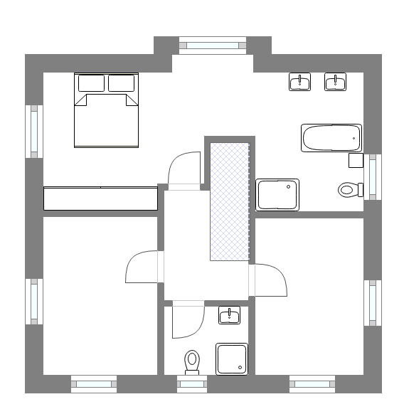

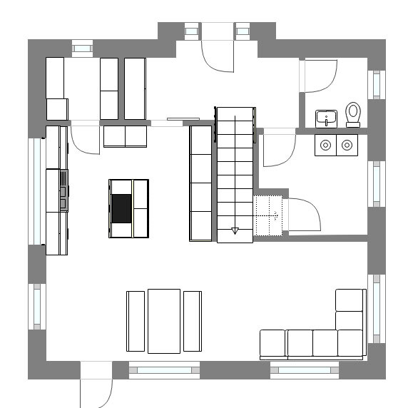

I have an updated plan. I extended the staircase a bit and added a bay window after all. This should help improve the cramped space in front of the stairs. There will also be an open, bright area in the bedroom. The shallow gable roof will simply be extended down at that point (I don’t know the exact term for this, see attachment).
What I don’t like so far: Since the staircase is now longer and extends somewhat into the living room, the basement stairs probably need to be moved to a corner in the utility room to avoid hitting one’s head. Unfortunately, I’m not familiar with stairs and their space requirements.
Do you notice anything here that definitely won’t work or is poorly designed?

You shouldn’t just focus on the benefits of the subsidy! For our part, we’re hoping to eventually have the mother-in-law as a tenant, at the latest when she retires. If that doesn’t happen, the space can be rented out to others and will still generate income.
And why do you want to install the staircase on the outside? Usually, the space for the staircase is already “lost” inside the ground floor.
The basement ceiling is insulated anyway; it might provide some minor additional support but not necessarily.
