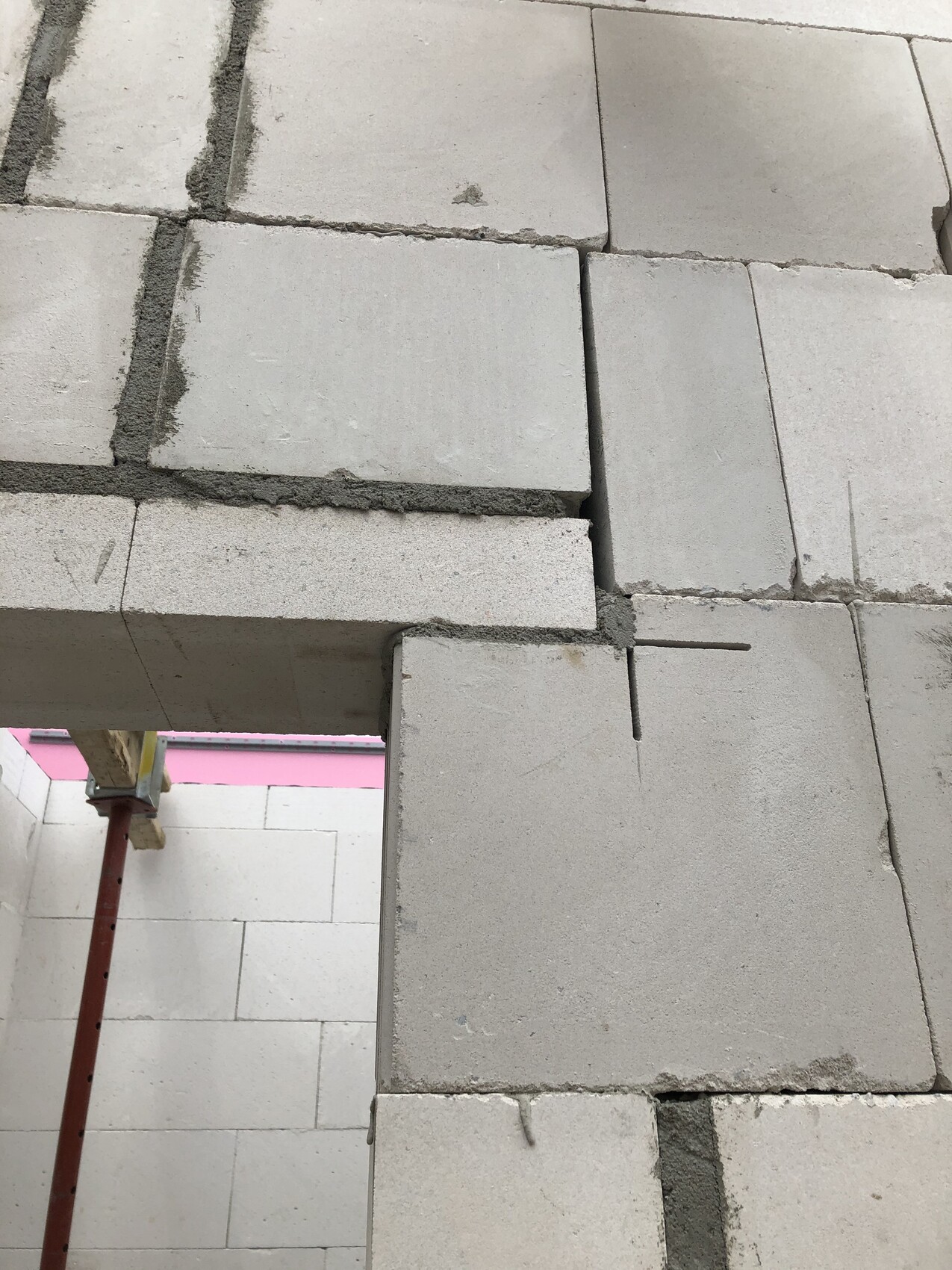

This is an interior wall, and some of the gaps seem very large to us.

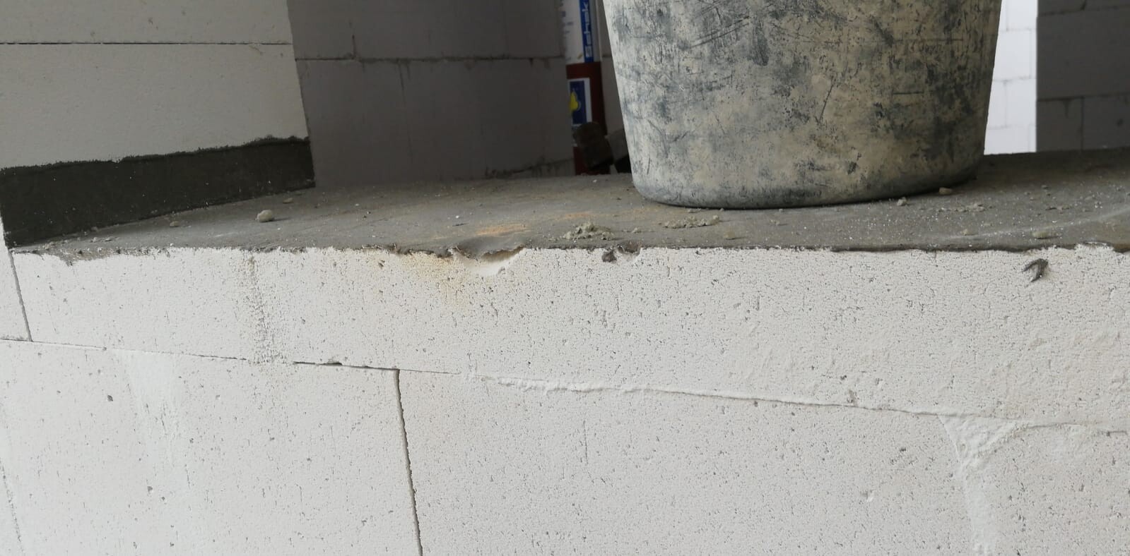

A block is broken off in the window reveal. Is this acceptable?

The small chip under the windowsill is just a cosmetic flaw that will no longer be visible once finished. The wall needs to be rebuilt starting from the lintel support; this is extremely poor workmanship and unacceptable. Even the mortar-filled butt joints reveal the careless contractor; however, there are two more serious mistakes: first, the person responsible for this work – calling them a "mason" would be misleading – apparently has no knowledge of proper overlapping of joints; second, it seems that the lintel itself is not a single piece. Continuing at the "break point" of the lintel without proper overlapping, and then further destabilizing it by the mortar-filled butt joint, is altogether too poor, even for a non-load-bearing wall. If you are a buyer, document the issues and kindly point them out; if you are the builder, call in the site manager and submit a written complaint about the defects. Send it as a registered letter with a return receipt.
knalltüte14 Jun 2020 06:41Well, it’s going to be more complex, but that shouldn’t be your problem.
The "mason" probably thought the joints should be nicely aligned for a neat joint pattern.
You need to point out to him that he’s mistaken and that he should reconsider his career choice. (Seriously: It’s okay to put it that bluntly.)

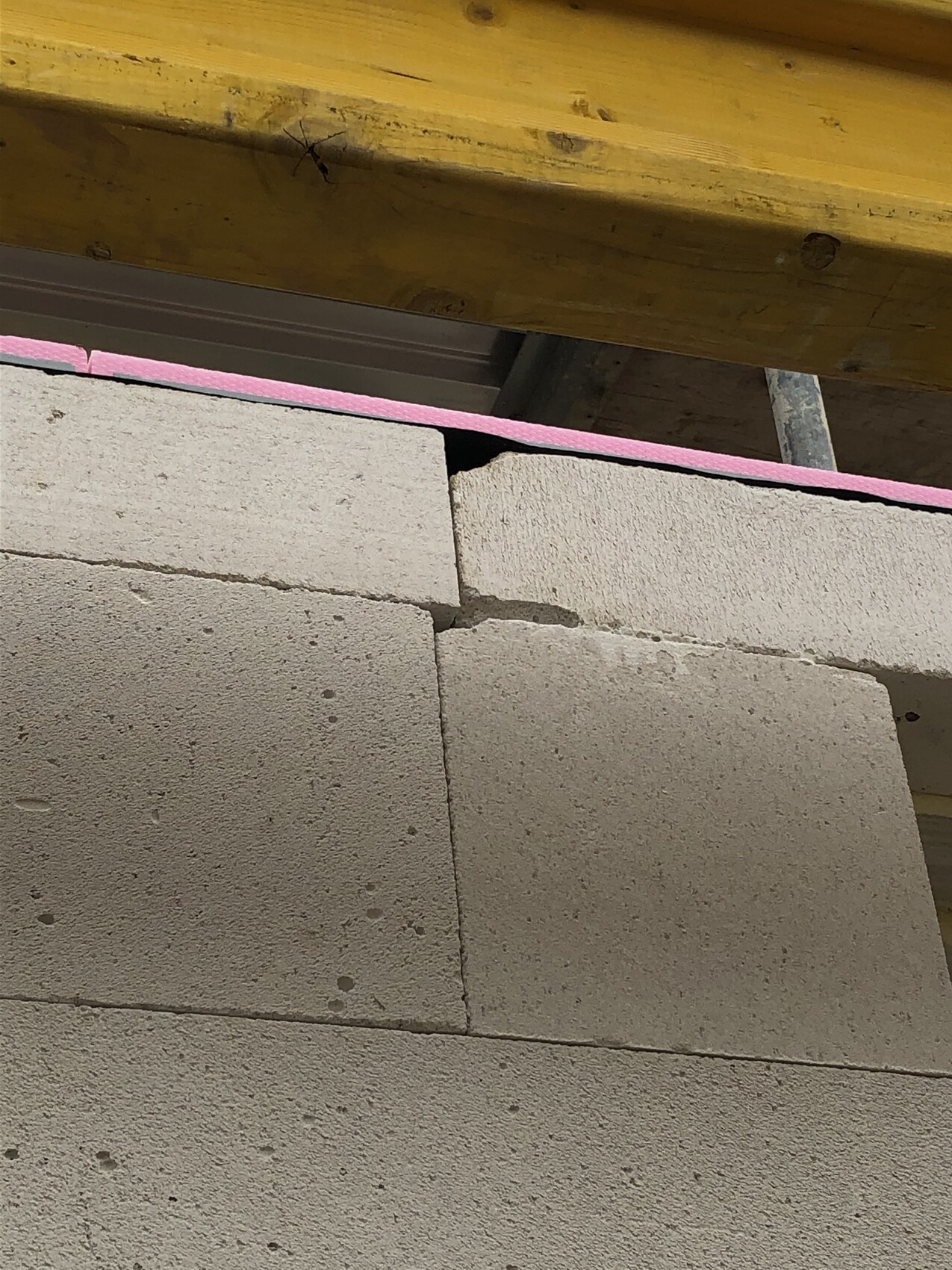

elsausb schrieb:
Unfortunately, the ceiling was already installed last week. Is the correction still possible? The correction is definitely necessary. This is a serious structural defect. The ceiling can remain in place, and the supports underneath can also stay for now, but I would currently advise against adding any walls on top of it. The creator of this work has managed to produce a perfectly formed crack that even a steel frame wouldn’t hold, and it makes every planned weak point pale in comparison. It seems the bricklayer was unavailable that day, and unexpectedly, the drywall installer ended up getting a leading role.
