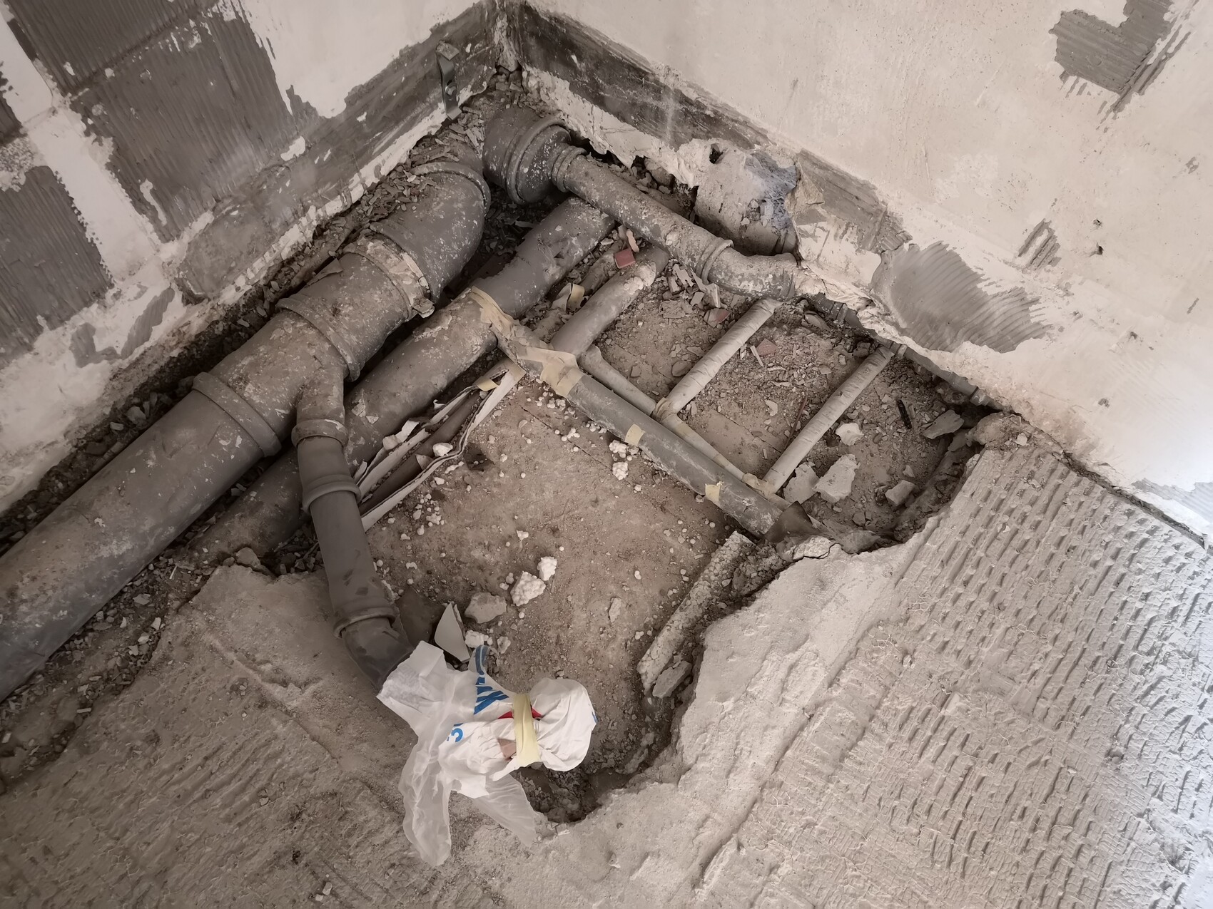

1. Previously, there was a bathtub with a drain in the middle; my new one has the drains on the side/near the beginning of the bathtub.
For this, I bought a "Viega Multiplex waste and overflow fitting." How can I connect my bathtub? See the photo Bad1_Bathtub. The old pipes and the multiplexer are still visible there.

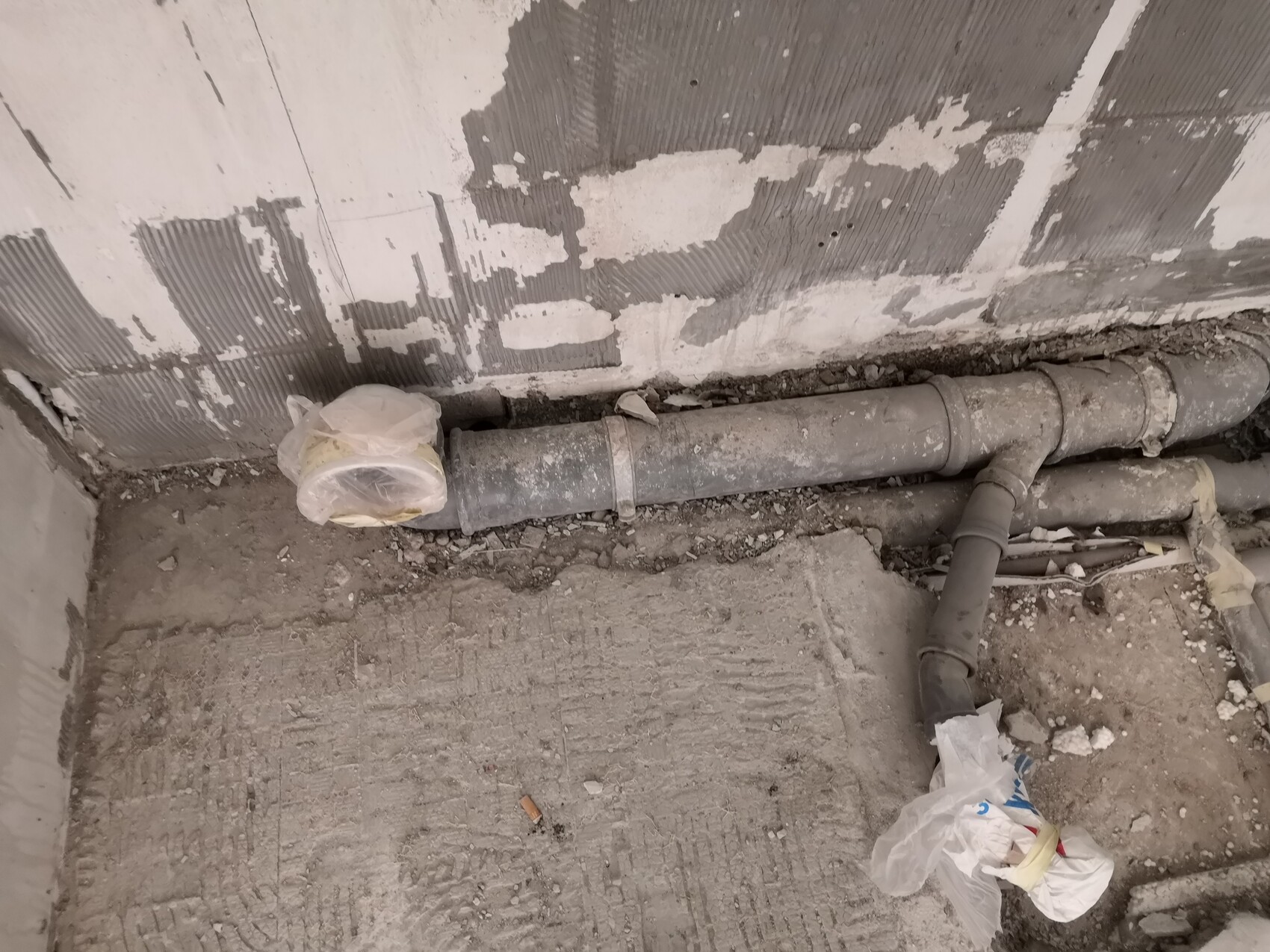

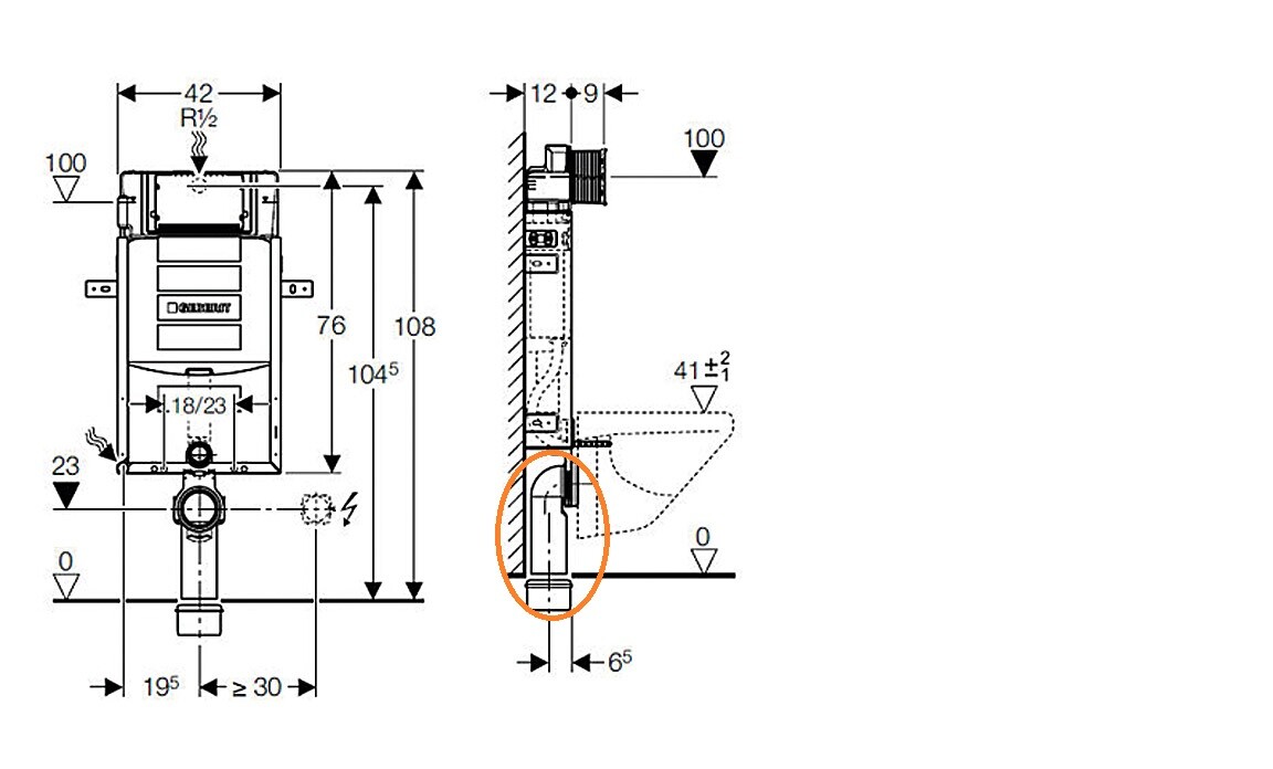

3. In bathroom 1, the concealed cistern fits well into the outlet pipe. In bathroom 2, I have a problem. According to the instructions, the wastewater pipe connected to the toilet (see the drawing of the cistern) must have a distance of 23 cm (9 inches) from the center to the floor. If I maintain this distance, I have to cut the supplied pipe almost up to the curve, making it too short to connect properly into the intermediate pipe and outlet pipe.
