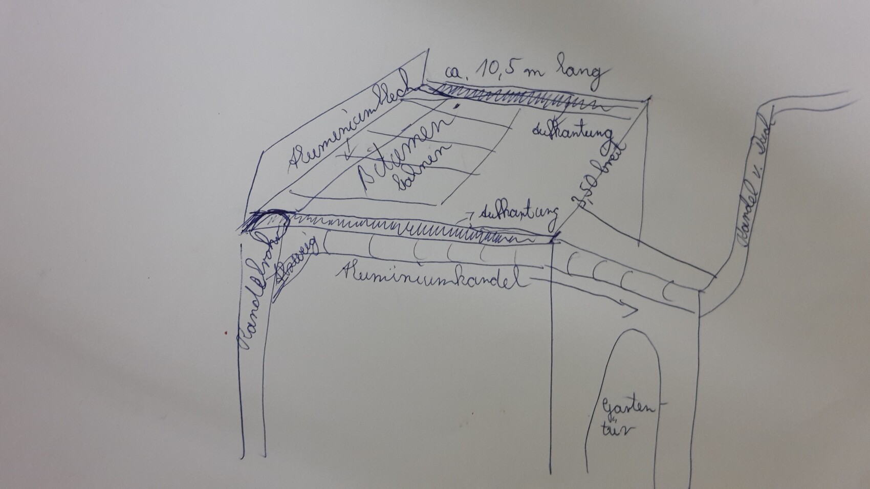

As a layperson, I tried to illustrate the work graphically... in case it might help a bit. So, we need to channel the water from the garage roof, because of the pergola, and also the rainwater from the house roof into the infiltration pit by laying a downspout pipe.
I already have some ideas... I also believe they are somehow feasible. I just need some "help."
