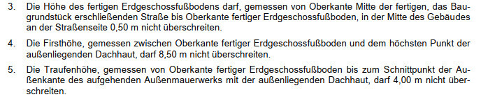

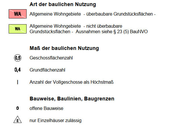

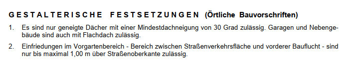

Here are the details from the zoning plan:

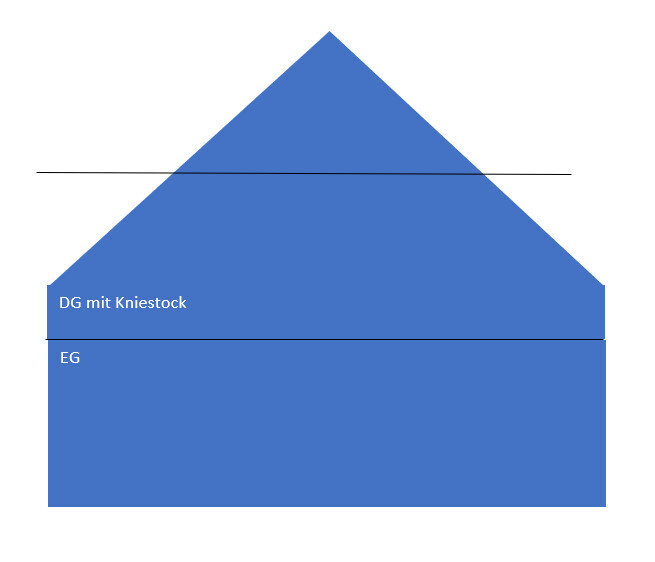

With a width of 10 m (33 feet), this is the maximum buildable size. The 4 m (13 feet) and 8.5 m (28 feet) limits are being respected. This means the narrower the building, the steeper the roof. With large dormers, you can be quite flexible on the upper floor. In my opinion, the two-thirds rule is not intended here, hence item #6 according to the development plan.
Is there a slope? You can also build with a 30-degree roof pitch, but then the attic space is less usable.
Please show us the entire development plan.
hanghaus2023 schrieb:
With a width of 10 m (33 ft), this is the maximum you can build.Exactly! This would fully maximize the space and add an additional full floor in the roof area. I actually sketched it out just before reading @hanghaus2023's post.Your desired townhouse isn’t possible, which is already evident from the 4-meter (13 ft) eaves height.
