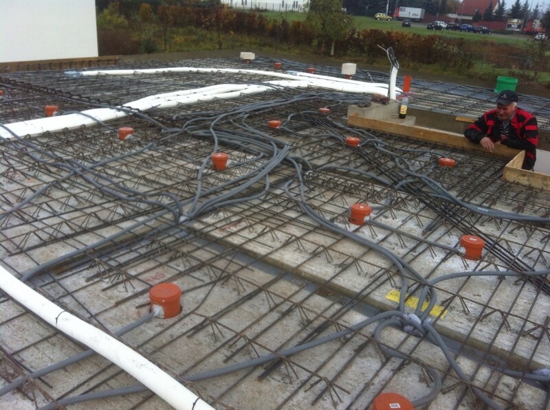

Did you simply encase the underground cables in concrete?
I didn’t dare to do that.
Reinforcement mesh on raw floor slab with cables and orange pipe sleeves; worker at the edge.
And no separation layer between the masonry and the precast hollow core slab?

These are not underground cables but special concrete cables—quite expensive, but no hassle with protective conduits...
Sebastian79
11 Jun 2015 20:38
What do you mean by separating layer? What is it supposed to be for?
