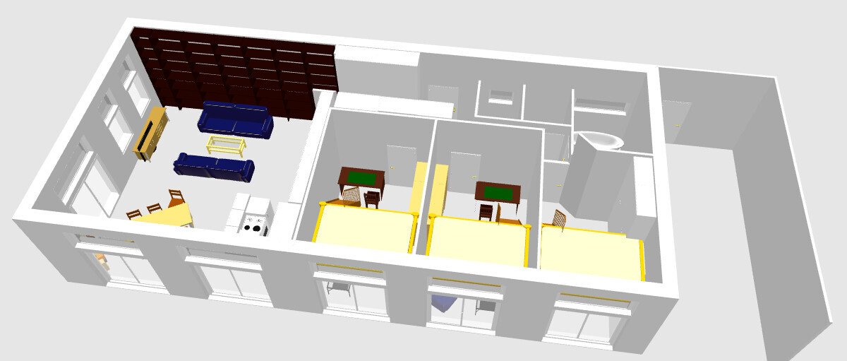

3D floor plan of an apartment: living room, kitchen, two bedrooms, bathroom, and hallway.
This is a rough idea for now, but the bathroom still needs some adjustments...
ares8327 Apr 2018 15:54
It looks like a prison with the small rooms and a very narrow corridor. And where is the utility room / mechanical room? That alone should be at least the size of the bathroom to accommodate the equipment and some storage shelves.

27 Apr 2018 16:06
A floor plan with dimensions would be helpful.
11ant27 Apr 2018 18:56
GooSe_77 schrieb:
That’s a rough idea,
Yes, definitely not gently melting. It looks like a conversion of five row garages.
