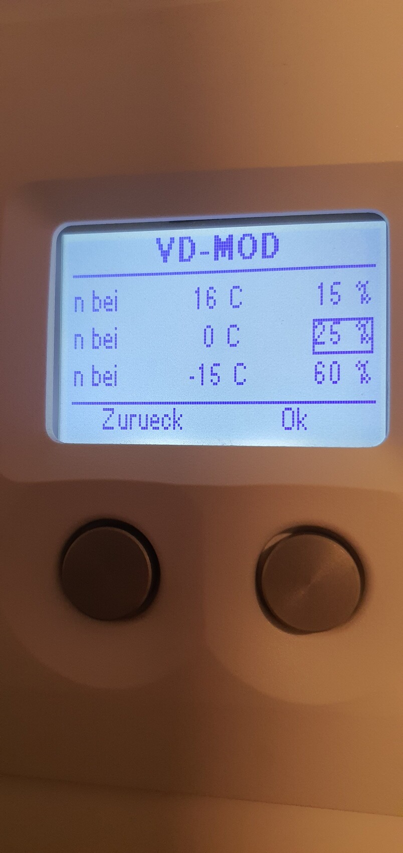

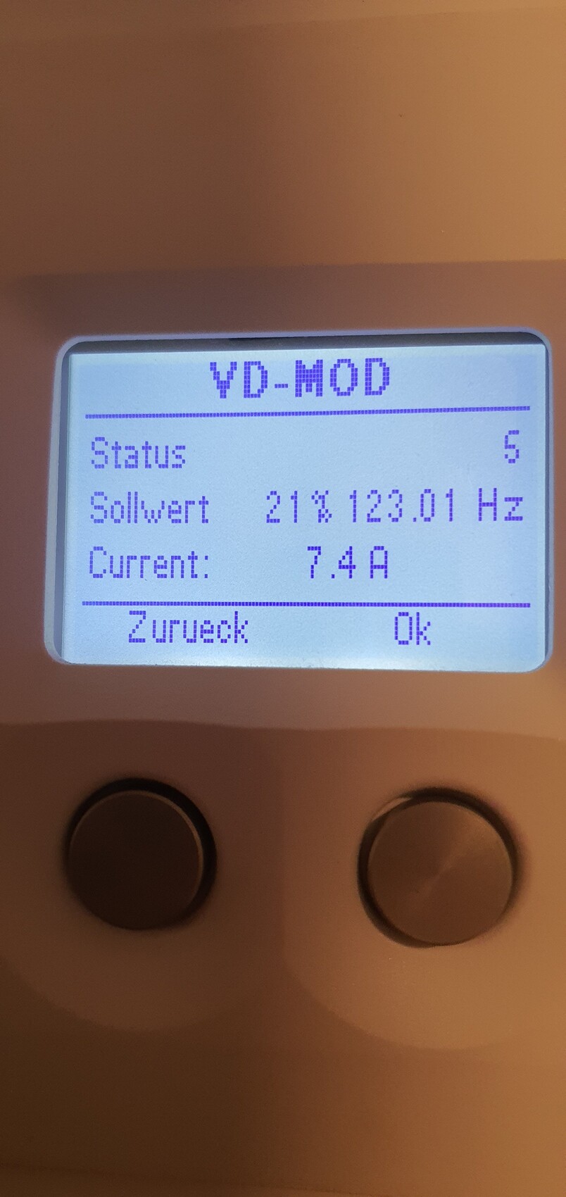

Here are my current values:

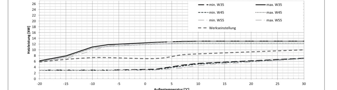

Then try lowering the compressor speed (VDmod) at 0°C (32°F). The BLW does not modulate between maximum and minimum possible output. Instead, the heat pump follows the compressor curve and reduces performance the closer it gets to the target return temperature. The power reduction can be adjusted using the control deviation parameter.
Remark: Compressor speed should never be below 15%. This was also set for me by the Brötje technician.
