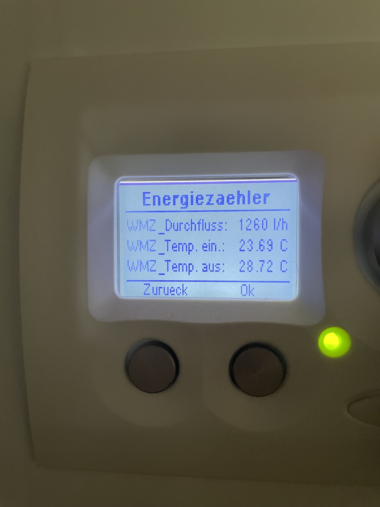

Is the electric heater active?I see that in the settings. Currently 6.7kW (about 22,700 BTU/h) with a COP of 4.9 = approx. 1400W (1.4kW) electrical input. It never runs below 6.5kW (about 22,200 BTU/h).The electric heater has never been active.

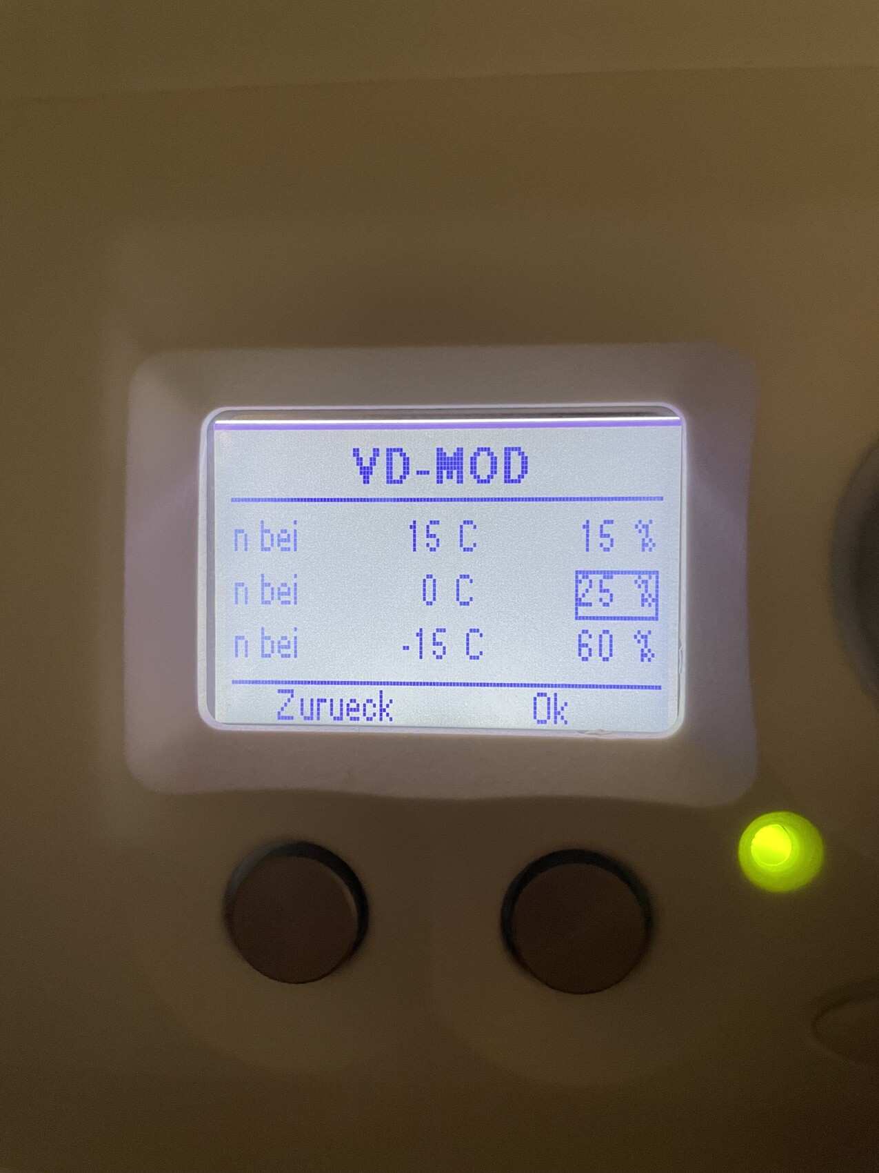

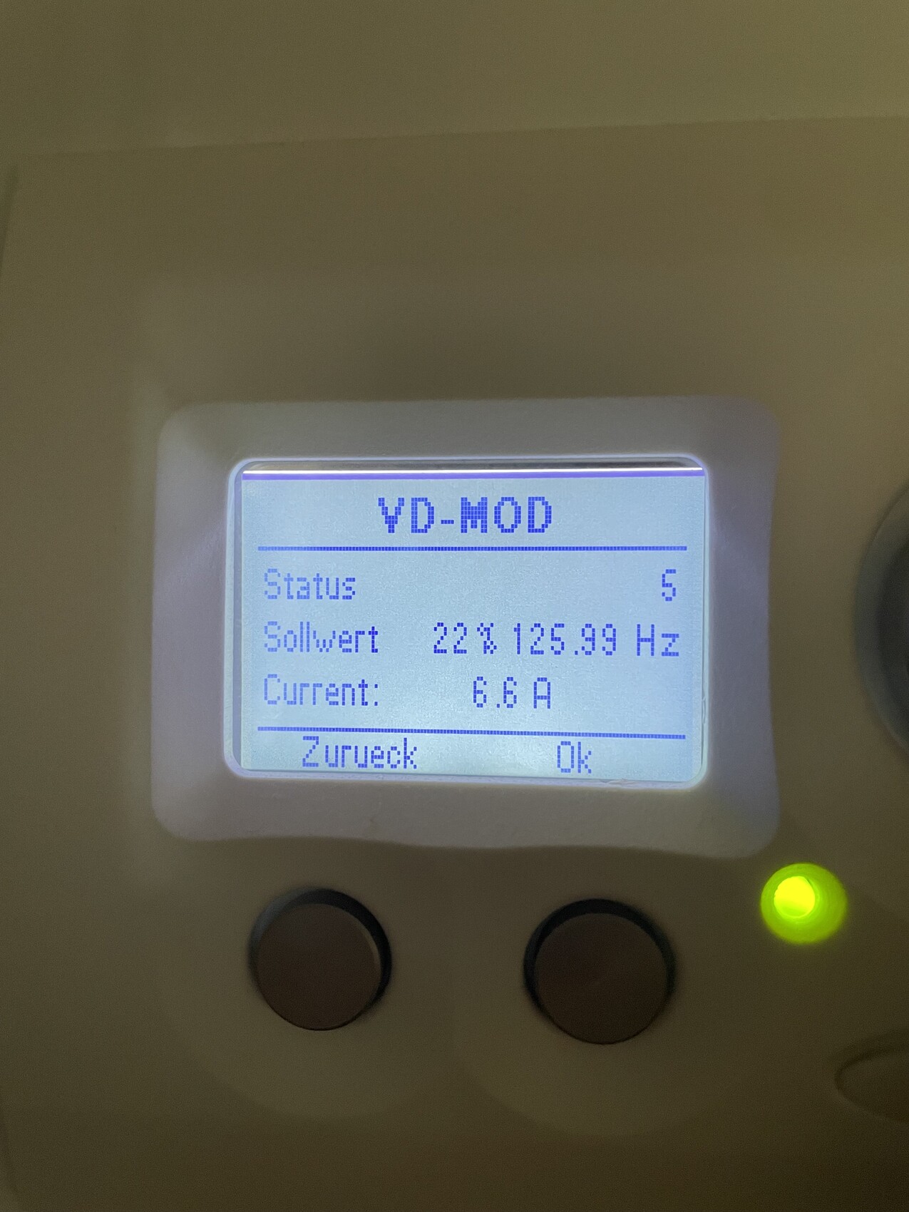

Alessandro20 Dec 2024 08:33It is already modulating as it should.
The display "WMZ_Leistung" is confusing. It decreases with falling outdoor temperatures, so it is not the heat pump’s output!
Don’t worry about the cycling. Even if it cycles 15 times per day throughout the year (which it doesn’t, because it only heats domestic hot water in summer), the compressor is rated for 150,000 starts and will last 25 years!
The hysteresis is also different compared to other manufacturers, so it needs to be understood differently.
I’m happy to help you again in two weeks, as I will be on vacation myself ;-)
