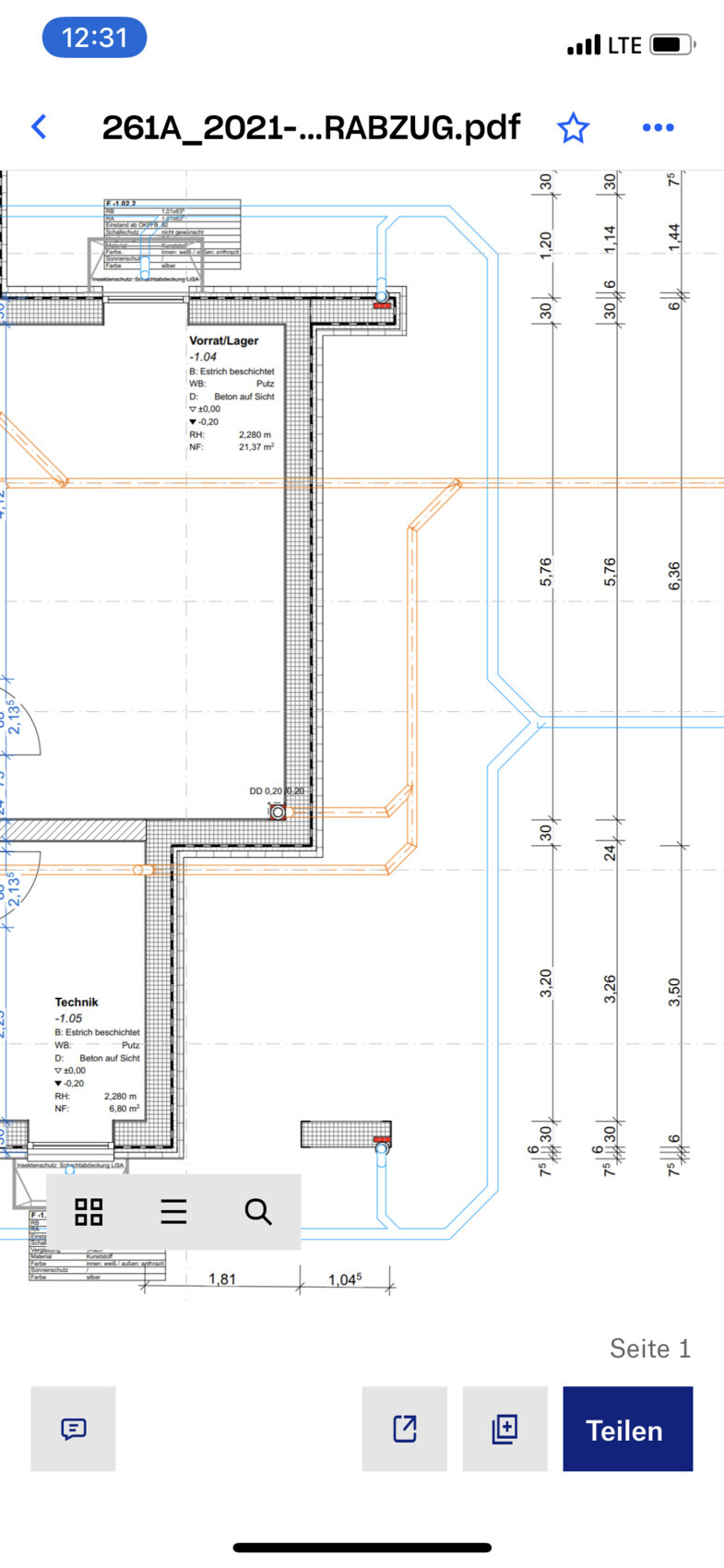

The downpipes are only planned within projecting walls that support the roof overhang. See photo. I can imagine that these may not be directly connected to the building envelope and therefore might not pose an issue from an energy efficiency perspective.
The argument regarding the water and heating pipes seems quite reasonable to me.
It would be interesting to know if anyone has had any specific negative experiences with this.

The downpipes are planned only in protruding walls that support the roof overhang. See the photo. I could imagine that these are not connected directly to the building envelope and therefore might not pose an issue from an energy efficiency perspective. So, you actually meant only the downpipes?
No, you’re right, at this point they do not interfere with the thermal envelope.
