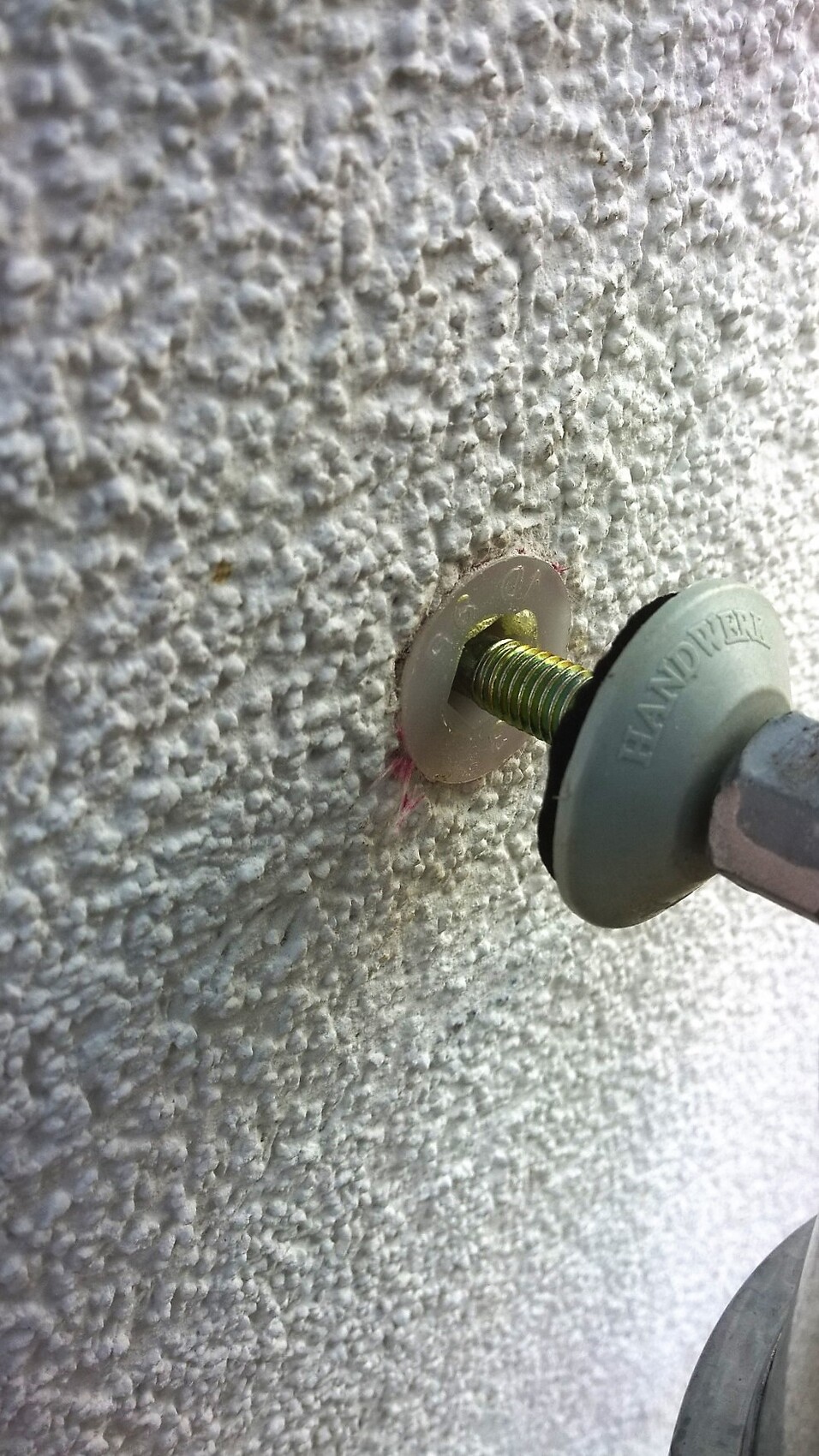

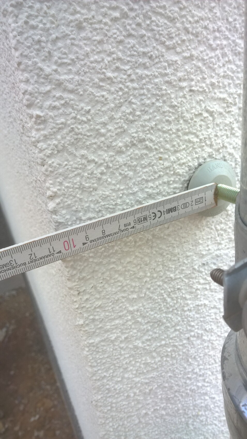

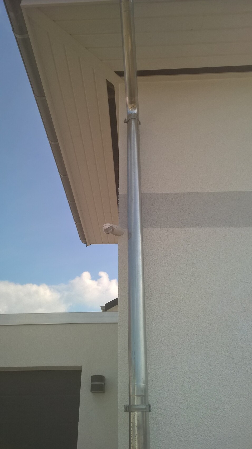

The downpipe is fixed to the insulation using pipe clamps, meaning it is not anchored into the masonry. The distance to the outer edge is 11cm (4.3 inches). Since the external thermal insulation composite system (ETICS) is 16cm (6.3 inches) thick, the downpipes cannot be anchored into the masonry without significant effort.
I have attached some pictures.
Longer screws won’t help here because there is no masonry at that point. If I drill deeper at that spot, the drill will just go sideways through the external thermal insulation composite system (ETICS) / external wall insulation.
If this turns out to be a defect, the downpipe will have to be completely removed, the gutter will need to be repositioned, and new holes will have to be made. The old holes probably won’t look good after repairs either.
