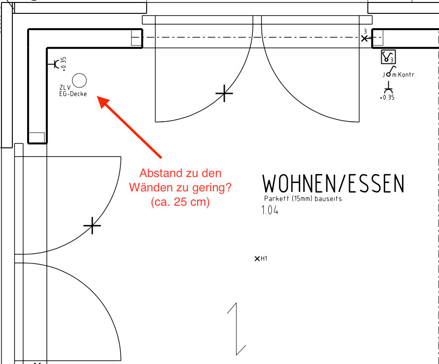

One more question for the controlled ventilation system experts regarding the placement of supply air vents in the ceilings.
I have often read that distances of at least 50 cm, sometimes 75 cm or even 1–1.5 meters (1.6–4.9 feet) from the walls should be maintained. Unfortunately, there are very different recommendations, and I cannot assess their practical relevance.
In my current detailed design, the distance of the supply air vents (ceiling) is only about 25–30 cm (10–12 inches), which feels too close, doesn’t it?
It plays only a minor role, and as long as the airflow in the room is ensured, it basically doesn’t matter whether it is 1 meter (3 feet) or 20 centimeters (8 inches) away from the wall.
More interesting and important is the design of the valve and its related flow characteristics.
Regarding airflow, I am honestly quite relaxed, especially after reading the research report "Air Movements in Naturally Ventilated Living Spaces"...
However, the (practical) distances from the walls and so on were unfortunately not addressed in that report. Therefore, my question is based on practical experience: what distances have others used? 🙂
The key point here is the "air turbulence" at the walls/room corners?
