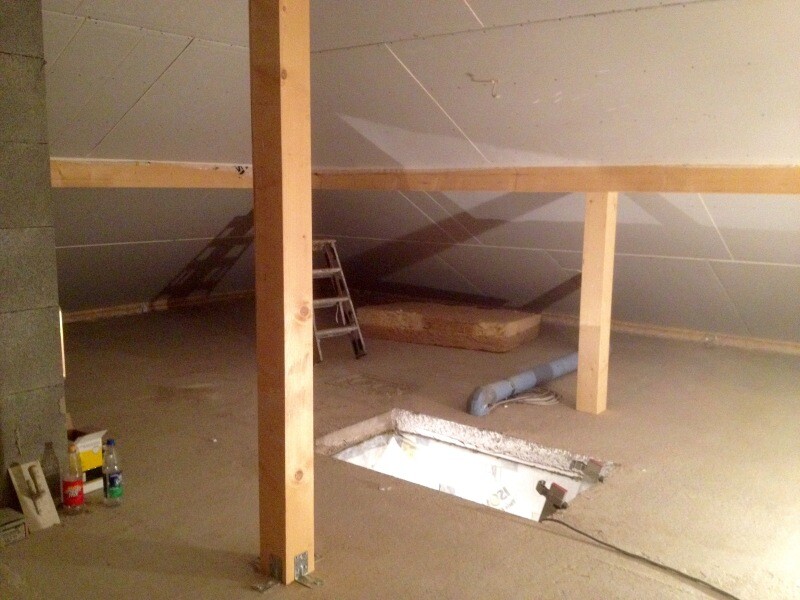

We have an 11x11 meter (36x36 feet) townhouse with a 28-degree roof pitch. The sloping ceilings have been insulated, covered with boards, and plastered.
There is plenty of space up there.
Here is just one photo from one side:
Later, we might install roof windows and partially convert the space into living areas.
kielersprotte23 Jul 2015 12:51This is exactly how I imagine it!! Thank you very much. What is the roof structure called?
