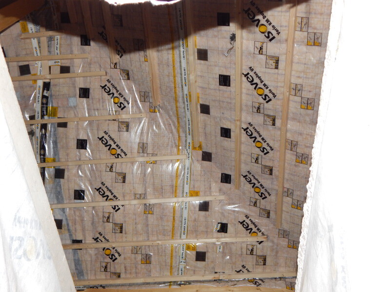

I would need to check exactly which insulation was used under the sloped ceilings. However, it was quite thick and has already performed very well during the summer.
The attic ceiling is made of concrete. Since the insulation is placed under the sloped ceilings (warm roof construction), we did not add additional insulation on the attic floor.
I can’t tell you the exact cost anymore. We basically included it together with the timber roof structure in the contract. From what I remember, the extra cost wasn’t very high, so we didn’t hesitate long to choose this option.
This is the only photo I currently have on hand (taken from the upper floor through the hatch) before the panels were installed on top (insulation etc. already in place):

Username_wahl23 Jul 2015 19:41And how are you planning to handle the staircase?

@Passivhaus: The hole looks smaller than it actually is. If the room is finished later on, a compact staircase will be installed from the upper floor hallway. This was planned from the very beginning.
