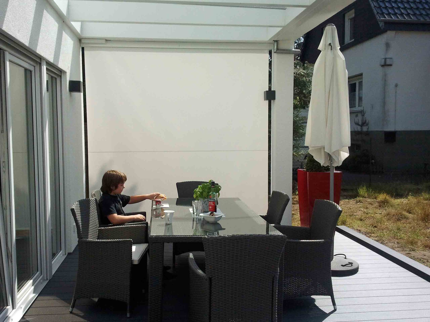

Bauexperte21 Aug 2014 12:04Hello,
Extending the roof across the entire width of the terrace will make the rooms underneath quite dark.
There are attractive alternatives that can suit the style of the bungalow; one example is attached. At the top, laminated safety glass (VSG) is installed, with a fabric sail attached on the side. For those who prefer, the VSG can also be shaded with a fabric sail; this has the advantage of keeping it bright.
For your design, a partial extension over about half the terrace is also an option; however, this would be along the shorter side, roughly up to the wall between the master bedroom and the child’s room.
Regards, Bauexperte
Voki1 schrieb:
Basically, we initially planned for a full roof covering. Actually, we’re also wondering if half of it might be enough. It would definitely be large enough.
Regards, Bauexperte
Hello, thank you for the answers so far. The roof is necessary because I am very sensitive to light. I definitely need shade in the sun and must not expose myself to direct sunlight for too long, even if protected. So, I need "real" shade. A roof seemed like the obvious choice for a bungalow, especially since most floor plans already include a (small) covered area.
