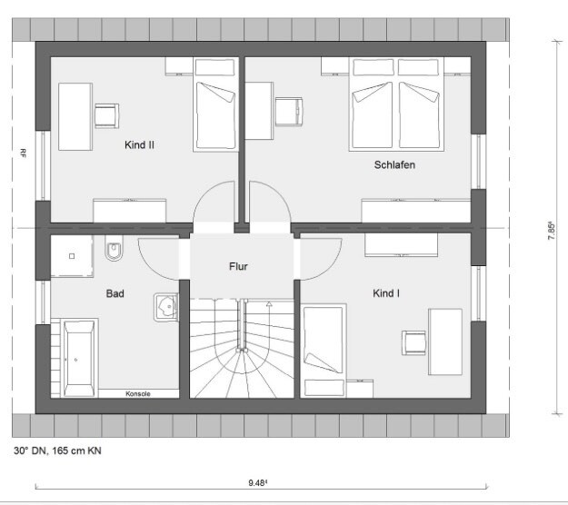

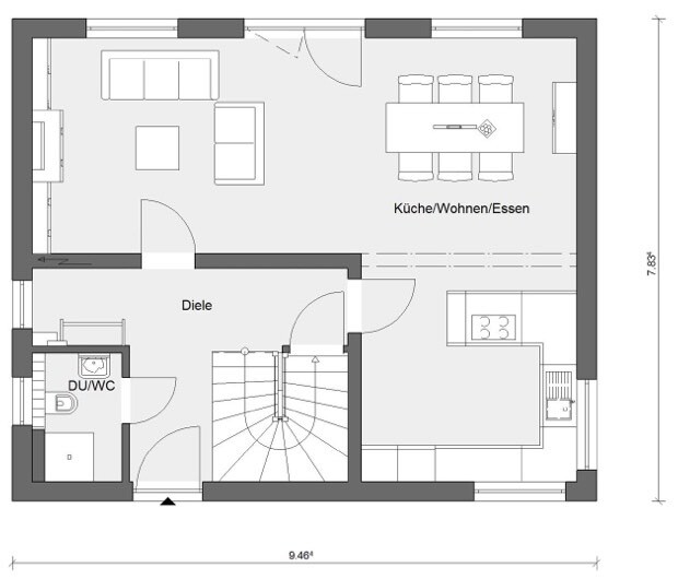

derwilder8515 Feb 2021 15:30Hello everyone, thank you very much for your opinions, and the majority would recommend a basement to us.
Currently, we have the attached floor plans as favorites. In the basement, you can still imagine a bedroom, bathroom, and office.
The development plan:
Budget:
- Single-story
- The attics can be full stories
- A knee wall up to 1.00 m (3.3 ft) in height is permitted
- Gable roof or shed roof with a maximum pitch of 45° is allowed
- Basements may count as full stories if the finished floor level of the ground floor is not higher than the adjacent street (measured from the center of the house to the outer edge of the sidewalk / kerb)
- The basement and foundation walls of the houses are built to be waterproof on the uphill side
Budget:
- We want to spend around 350,000 EUR ($) for a turnkey house, excluding additional construction costs and earthworks

Most of those who wanted to build without a basement here would have ended up pouring tons of concrete for retaining walls, plus a lot more soil to level the whole area. That’s exactly why I have my basement rule—not just an old wives’ tale from a pub conversation, but gathered experience from forty years of working in construction—that a basement, where it is not truly avoidable, 1. incurs costs comparable to actually building it when used as a “substitute measure,” and 2. this applies not only to clear cases but also proportionally to all the “grey areas” in between; specifically, for every 20cm (8 inches) of height difference (within the foundation slab area), add ten percentage points. Up to about two meters (6.5 feet) height difference, a basement not built is effectively cost-equivalent to one built.

# Is a knee wall with a maximum height of 1.00m (3 feet 3 inches) allowed I read this as “one plus attic, attic without avoiding a full floor, but from the 1m (3 feet 3 inches) line upward to be executed as a pitched roof.”
derwilder8515 Feb 2021 15:48Correct 1 + attic
