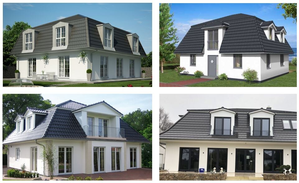

Mottenhausen20 May 2019 10:14For situations like this, clever people came up with the mansard roof townhouse as a practical solution. Although it was mentioned earlier, I’ve put together a few images to provide a better basis for discussion:
On the upper floor, there are usually no sloped ceilings; the interior walls are simply set back according to the roof pitch.
