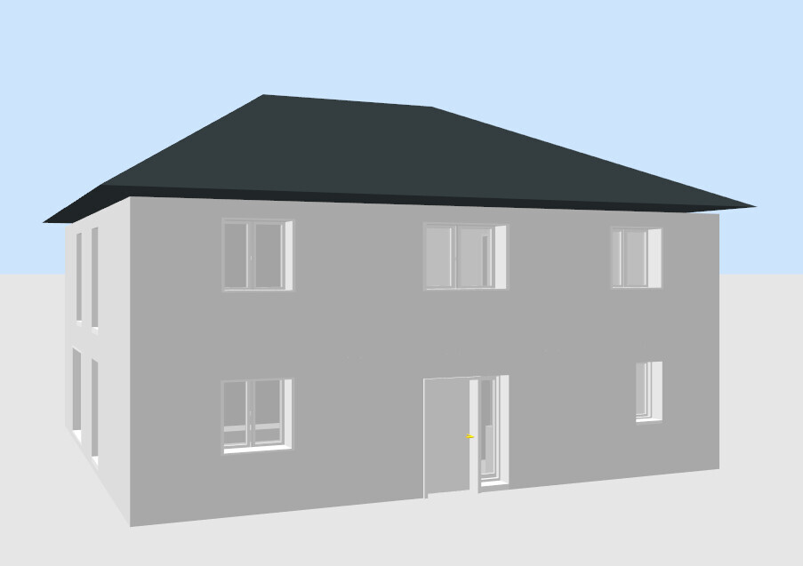

Just for comparison, the house with the hipped roof. The expansion potential here would be severely limited, and we might have to consider a basement.
