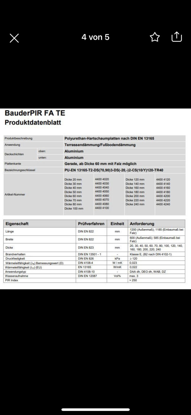

10cm (4 inches) PUR (thermal conductivity 0.025 W/(m·K), foil-faced) has a U-value of 0.235 W/(m²K). Nonwoven-faced (thermal conductivity 0.028 W/(m·K)) would have 0.261.
14cm (5.5 inches) mineral wool (thermal conductivity 0.040 W/(m·K)) has 0.266 W/(m²K).
Can this be used as 100mm (4 inches) insulation for the basement and upper floor ceilings? Is that sufficient?
BauderPIR FA TE product datasheet with rigid PU foam boards, dimensions and properties.
