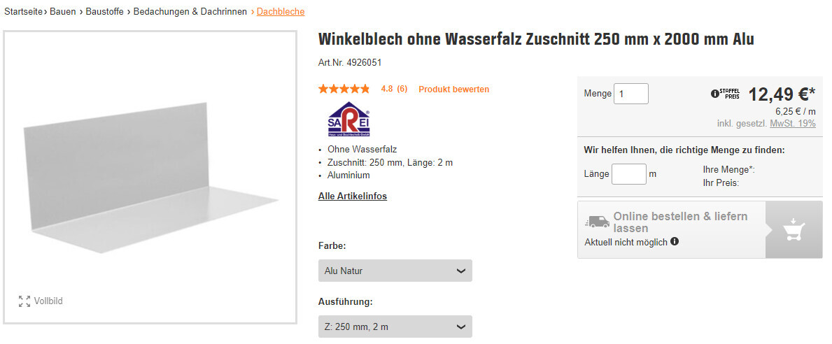

I was thinking of something like this:
Silver aluminum angle profile in L-shape, 250mm (10 inches) leg, 2000mm (79 inches) length
@Bookstar: What kind of rubber?

Bookstar
31 Mar 2020 16:02
Just search for washing machine underlay; you can already find perfectly cut ones at Hornbach. This way, it won’t stand in water and is ventilated underneath.

Alright, I’ll give that a try. Do I still need the drip edge, or is it enough if I cut the mat only 3cm (1¼ inches) wide and the wall, which is 4.4cm (1¾ inches) wide, slightly overlaps it?
