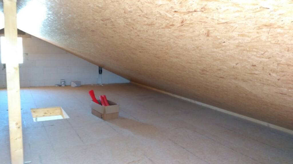

Ulrich Fuckert schrieb:
I have seen too many roof structures with a wood fiberboard that ended up with significant mold growth. But the photo on the left was from a new build, right?
Knallkörper29 Jul 2017 01:32Ulrich Fuckert schrieb:
I have seen too many roof trusses that included a wood fiberboard, which unfortunately led to significant mold growth.But that is a solid wood boarding combined with what is likely a missing vapor barrier!
