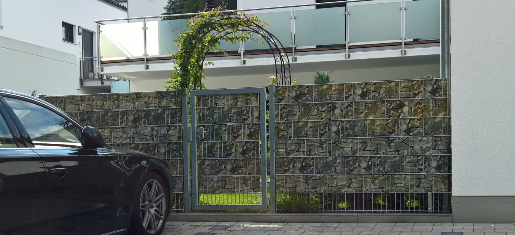

And PS: the pressure from these gabions really doesn’t make things any easier. Sorry. Well, I actually find it looks perfectly fine in real life:
