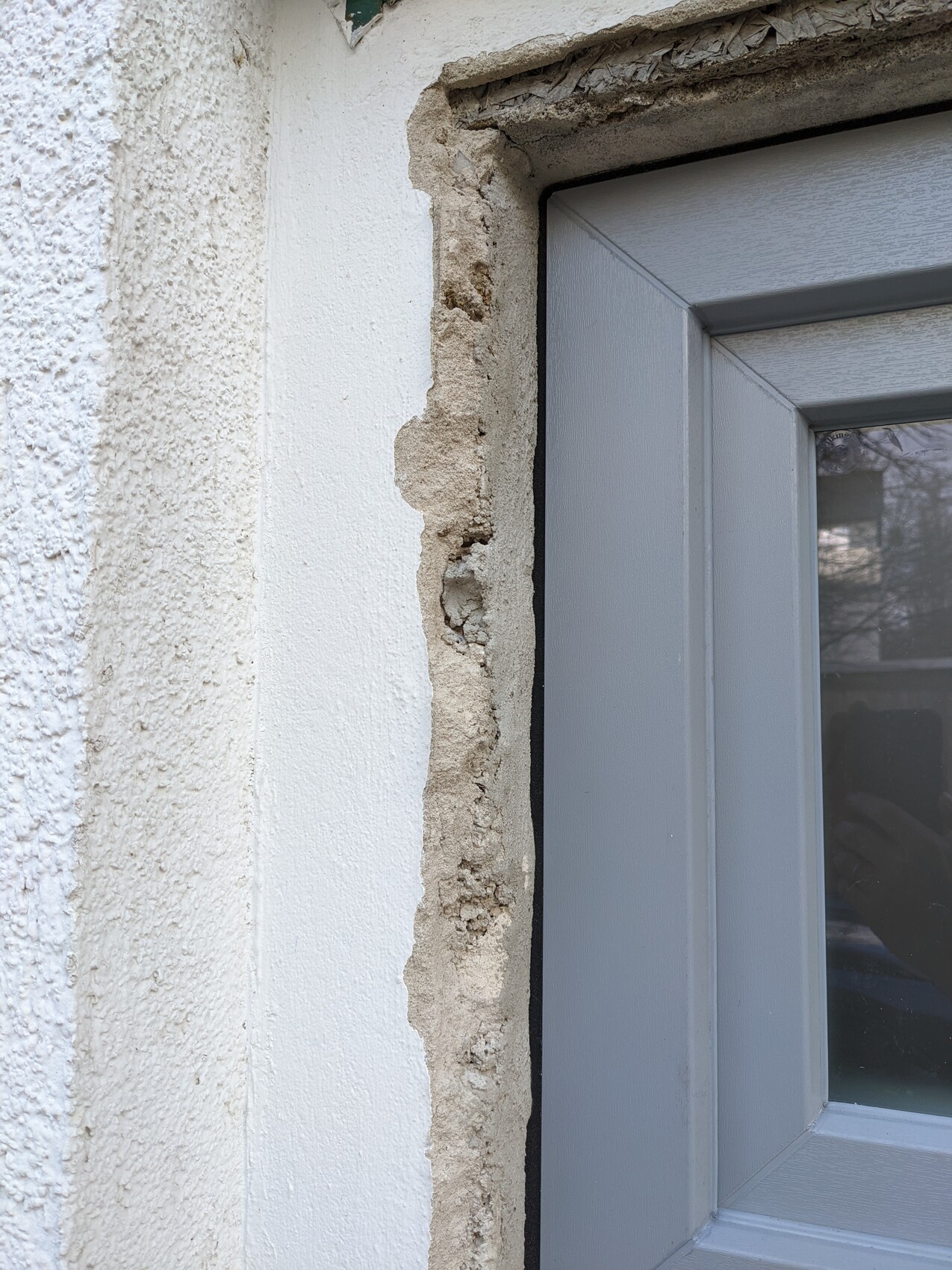

Is the window installer actually tasked with new construction windows or renovation windows? In the latter case, the size will probably be smaller than the original. This is because you want to avoid chipping and plastering work as much as possible. In addition, the actual rough opening dimensions are not necessarily known.
In such cases, installers tend to play it safe by ordering smaller windows, then generously filling with foam and finishing with trim.
Based on similar experiences in the basement, I decided to order and install my hallway windows myself.
I read the handbook from ift Rosenheim and tried to acquire the best possible layman knowledge.
At the top and sides, there is a combination compressible sealing tape from illbruck; beneath the windowsill, the matching foam. At the front, it is sealed weather-tight against driving rain with the system’s membrane, and afterwards everything is plastered and integrated into the existing insulation.
On the interior side, a special sealing compound is used to seal the joint at the windowsill, then plastered at the sides and top, and wallpapered.
No unsightly cover strips, but also a lot of work and mess, since the window opening was restored to rough opening level.
