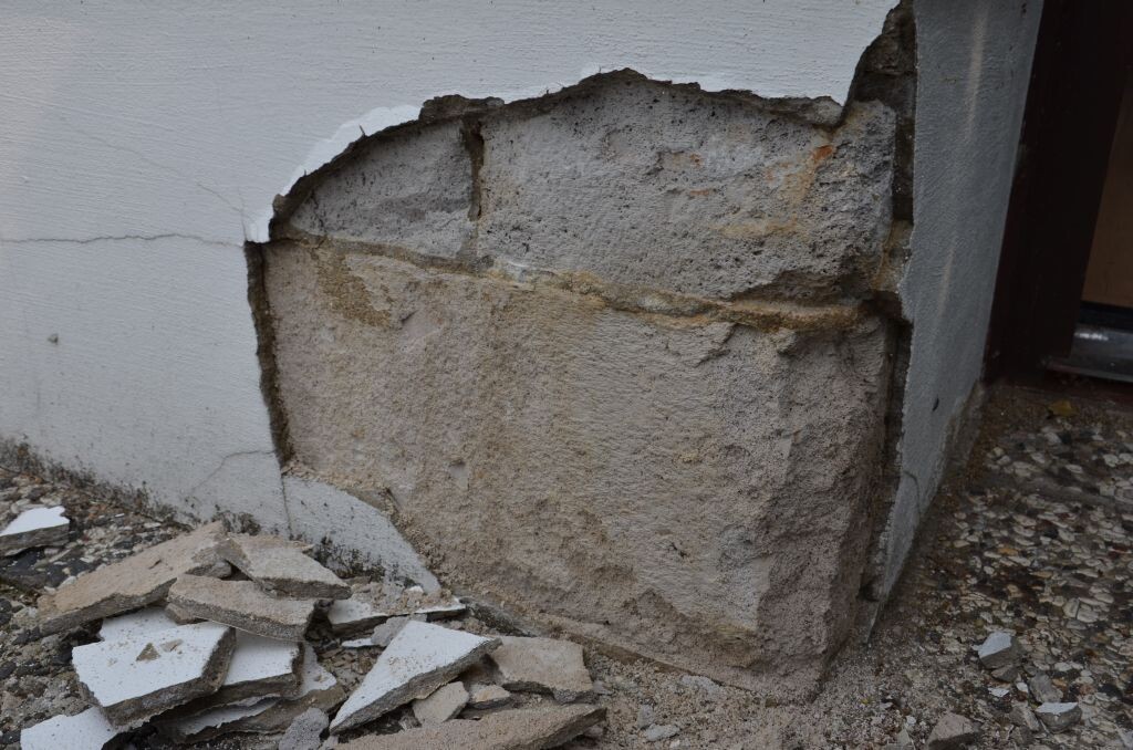

Hello forum members,
do you have any idea if I can use hacliath facade plaster here?
Thanks for your answers
Angela
External wall with plaster damage, loose plaster residues and construction debris at the foundation area
J
James23
9 Sep 2014 09:24
Hey anneelbe,
Hagalith should work fine. I personally prefer synthetic resin plasters.
Altbauprofi9 Mar 2015 22:17
I would use pure air lime mortar.
