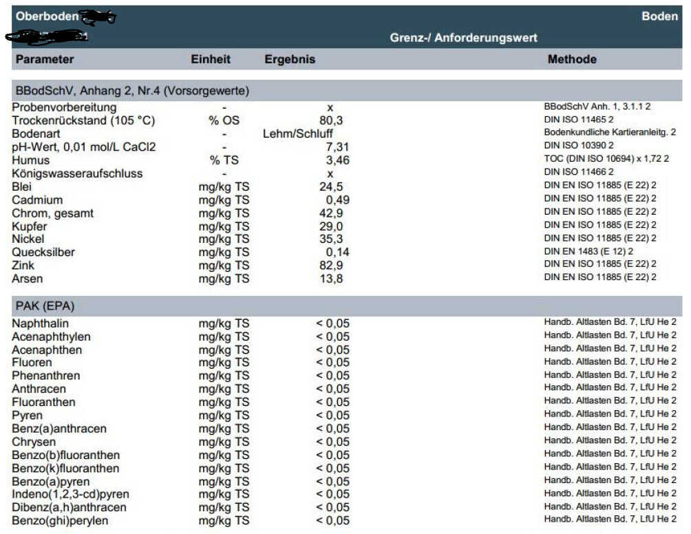

erazorlll5 Feb 2020 09:52This is a contaminant report.
If your plot of land is not suspected of contamination, you usually do not need this.
You need a geological survey and the related foundation recommendation.
In some areas, the soil composition is very homogeneous, so the neighbor’s report might be sufficient.
However, it is generally advisable to have your own report prepared.
The basic option with two boreholes should be sufficient.

erazorlll5 Feb 2020 10:11apokolok schrieb:
This is a contamination report.
If your plot is not suspected to be contaminated, you usually don’t need this.
You need a geological report that includes foundation recommendations.
In some areas, the soil conditions are very consistent, so the neighbor’s report might be sufficient.
A simple version with two boreholes should be enough. Thank you for your response.
The report also contains additional assessments of soil composition, soil function, etc., but these are mostly descriptive.
So, does this mean I definitely need the report and that I could also commission it before the actual house design phase?
