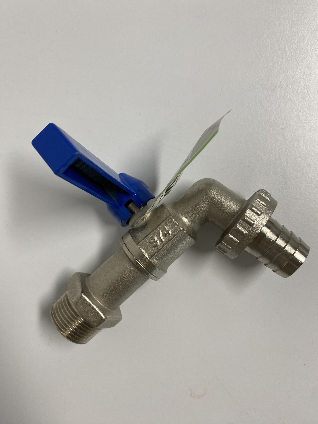

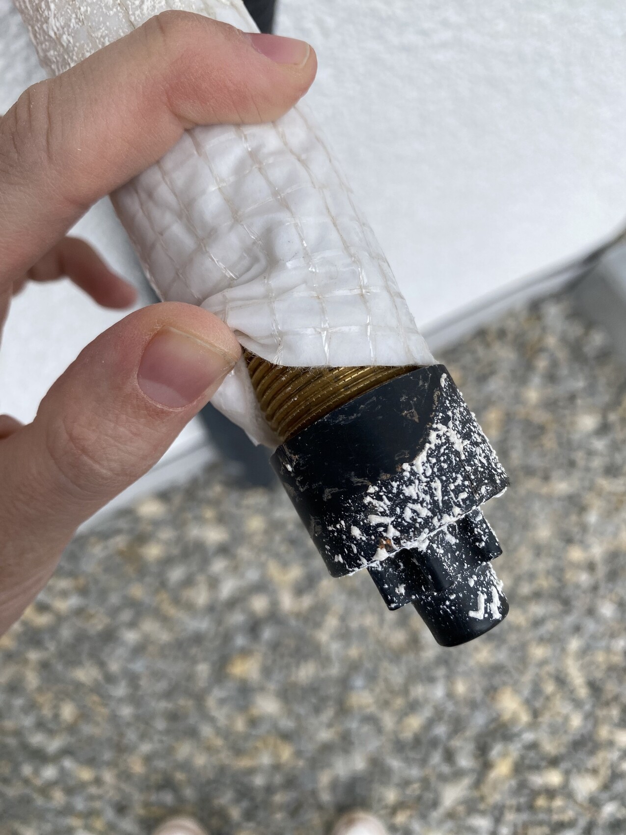

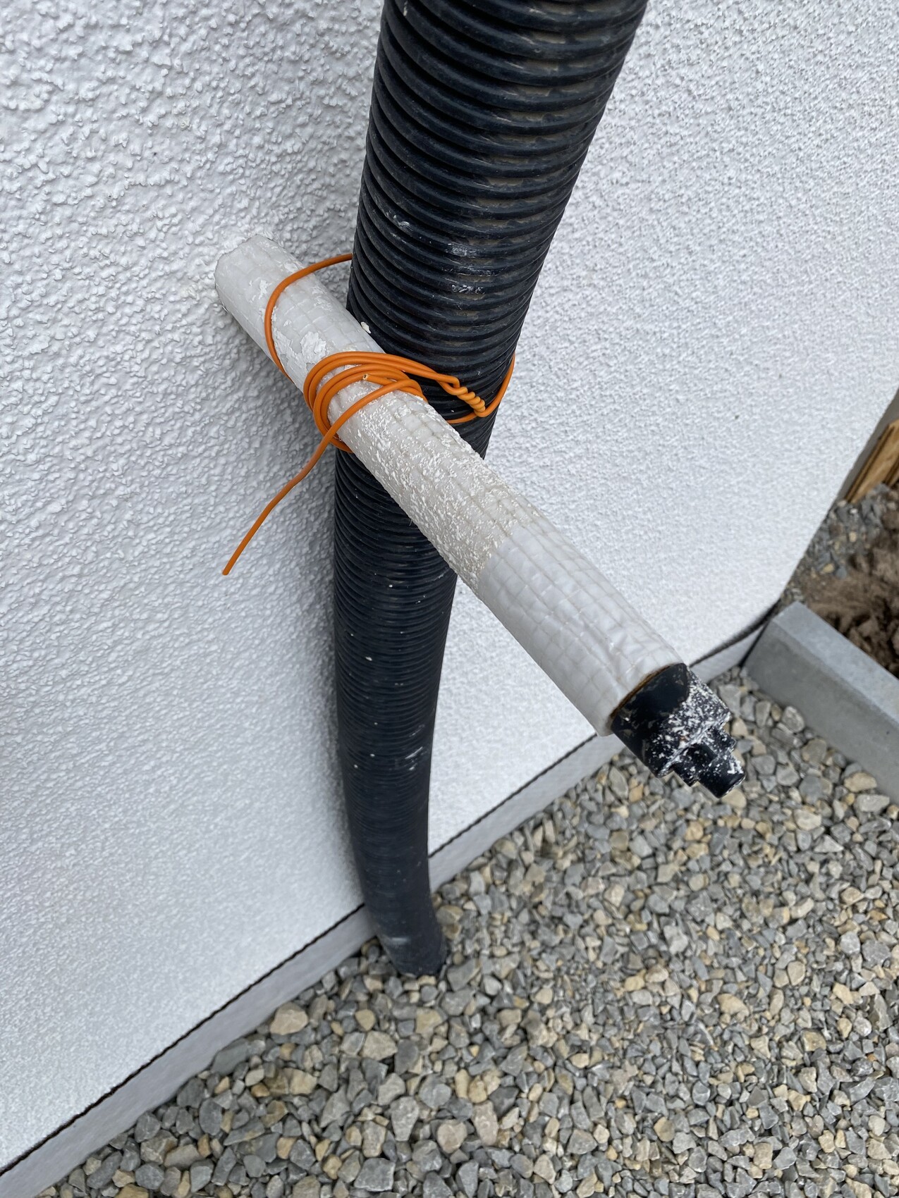

We have planned an outdoor water connection on the garage. There is a threaded pipe protruding from the wall. Unfortunately, I don’t know the correct technical term, so I have no idea what keyword I should search for.
How can I connect a faucet here? The pipe sticks out quite far from the wall. I have already bought a faucet.
Thank you very much and best regards
Nine1992
Aussenwand mit schwarzen Rohrleitungen, weisses Isolationsrohr und orange Kabel, Kiesboden.
Hand hält ein weiß umwickeltes Rohrstück mit Gewinde und schwarzer Kappe, staubig.
Metall-Eckventil mit blauem Hebel; links Gewinde, rechts Schlauchanschluss.

This is the preparation for a frost-resistant outdoor tap.

I looked it up now, and there is a rod inside the pipe. But shouldn't the pipe be inside the wall? Or does it need to be shortened?

This will be shortened. There are different manufacturers. Unfortunately, I do not know if the preparation fits all manufacturers.

I found a video tutorial and a manufacturer that offers products for the thread size. Thank you very much.
