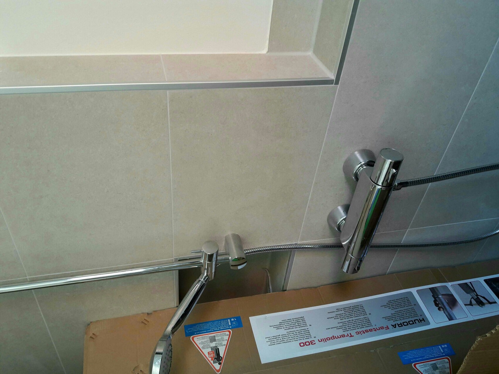

Build a support frame first. Then you can also create a storage compartment.
Not the best photo, but it serves its purpose.
Chrome shower fixture with hand shower on beige tiles in the bathroom.
sven.conzi13 May 2017 10:33
In our case, the storage compartment is integrated into the pre-wall (drywall construction). The supply lines for the overhead shower, etc., are also routed behind the pre-wall.
