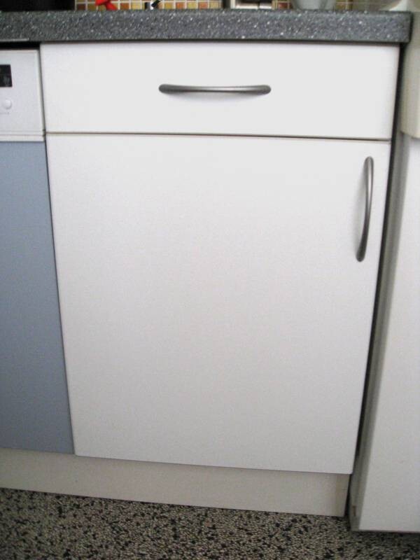

IKEA-Experte14 Aug 2013 14:22After my last move, I had no choice but to use my 50 cm (20 inch) wide base cabinet as a sink cabinet.

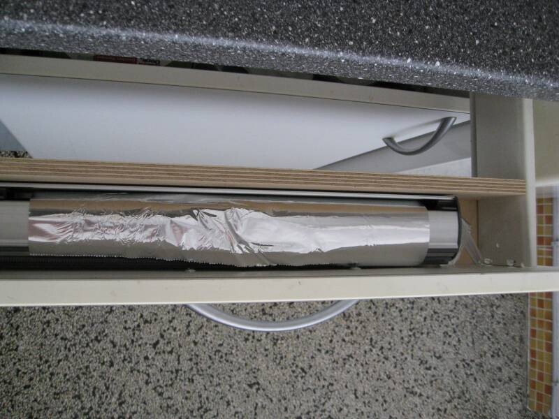

As you can see, there was also a version of the cabinet with a drawer. Of course, this can no longer be used with the sink installed. However, I did not want to permanently fix the drawer front as a panel. That’s why I installed a small drawer that uses the space between the front and the sink. Now, this is where the aluminum foil is stored.

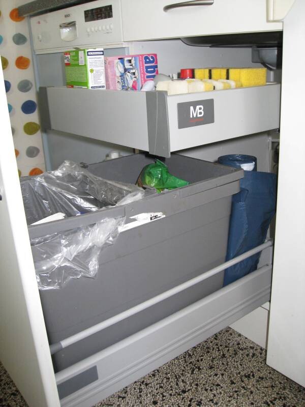

Below, I installed a standard RATIONELL pull-out drawer where the trash bin and other items fit. Above that, there was still room for a 30 cm (12 inch) deep inner drawer. Ikea does not offer this, so I used the Polish GTV Modern Box. However, I would not choose this manufacturer again, as their customer service is very poor or basically nonexistent.
