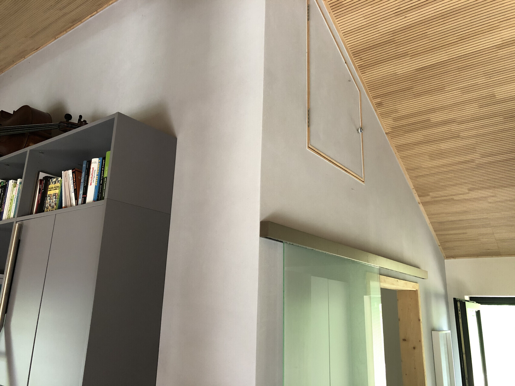

hampshire20 Jun 2021 14:22We faced the same challenge and closed off the space above the bathroom. The entrance is very narrow and has a simple handmade door with a surface coated in the same clay plaster as the wall. Upstairs we store children’s toys, old photos, and seasonal decorations :p. To access it, we use a ladder since we almost never need to get in there. Here is a quick snapshot:
pagoni202021 Jun 2021 08:35hampshire schrieb:
We had the same challenge and closed off the space above the bathroom. The entrance is very narrow and features a handmade simple door, with the surface coated in the same clay plaster as the wall. Up there, we store children’s toys, old photos, and seasonal decorations :p. To access it, we use a ladder since we hardly ever need to go up there. Here’s a quick snapshot:
[ATTACH alt="tempImagem1eMTv.png"]62773[/ATTACH] Thanks, we have a similar situation in terms of use. Unfortunately, we can probably only access it from the living area; the hallway would have been preferable, but in the end, it will likely just fade into the background again. So it will probably be something like that; the open space was more of an initial whim that looked quite nice in the photo..... 😎
