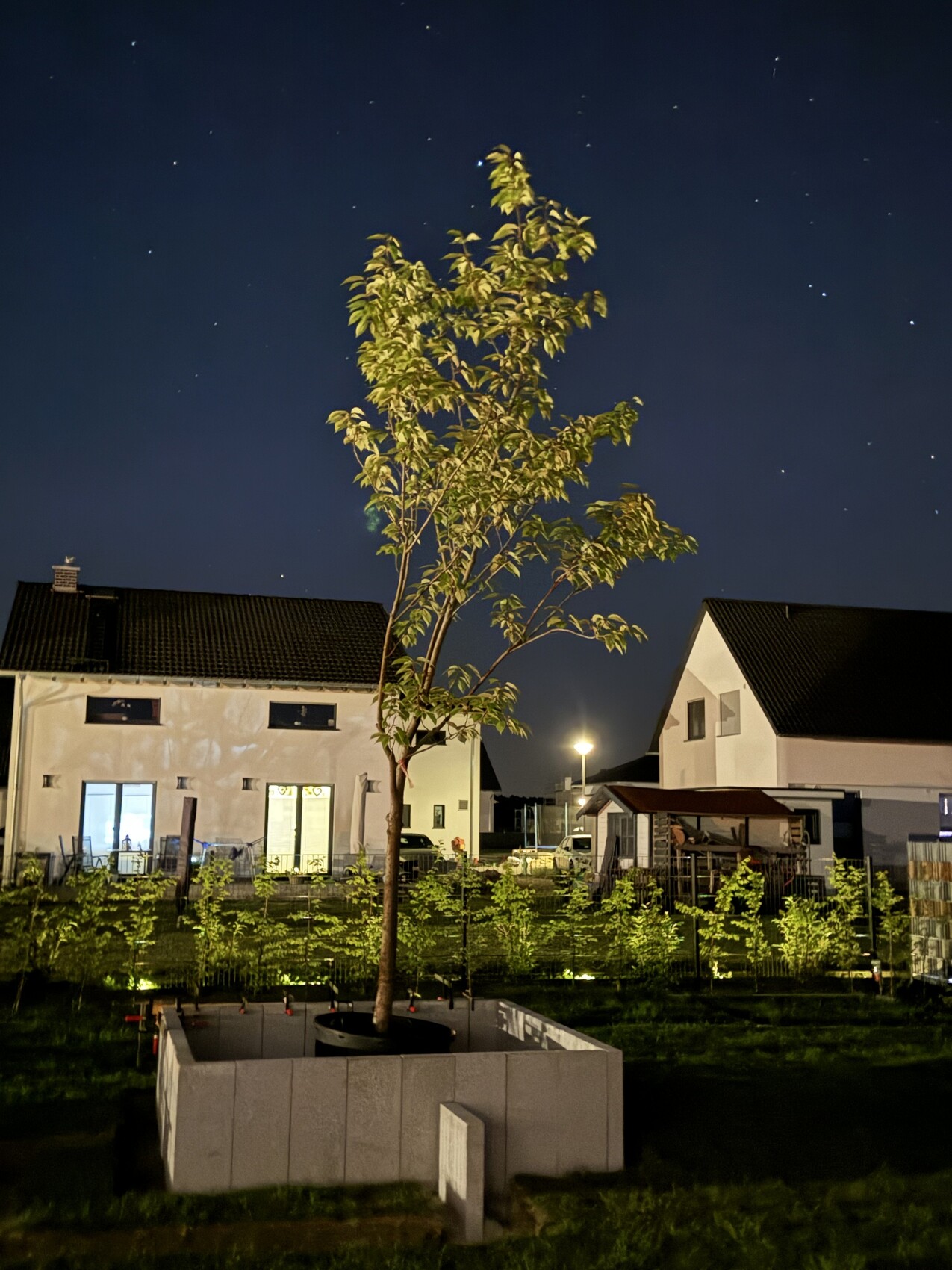

Hello, as a tribute to our late son, we want to plant a tree for him in the garden. It is a flowering cherry tree.
The tree is intended to be the visual centerpiece of the garden.

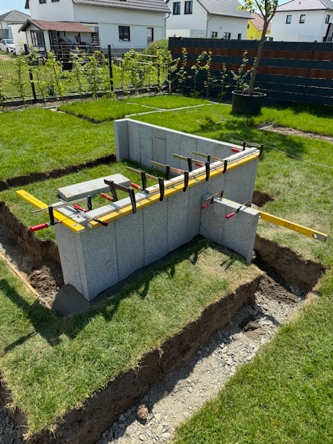

Therefore, I have built a raised bed from granite palisades.
These are 75cm (30 inches) high and will ultimately protrude 50cm (20 inches) above ground level. Nearby there will be a wildflower meadow; here the palisades are 50cm (20 inches) high and will stick out 30cm (12 inches) from the ground.

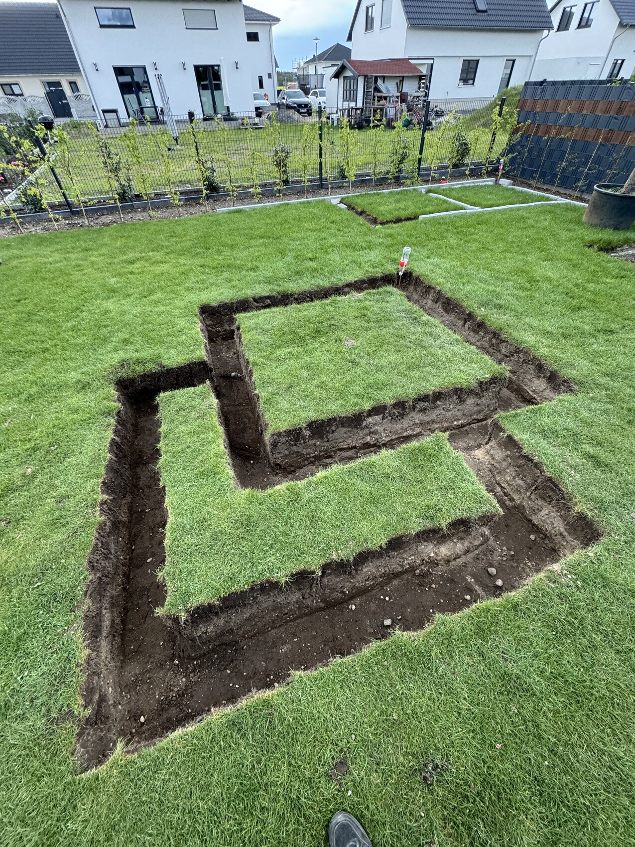

I applied 10-15cm (4-6 inches) of frost protection material underneath, compacted it, and then poured the concrete. The palisades are each set in concrete to about 25cm (10 inches) and 20cm (8 inches) respectively.
Now everything should slowly be refilled with soil.
Does the dimpled membrane (often recommended) have any purpose other than preventing soil from falling through small gaps? Granite is a stone that generally does not absorb moisture.
In this case, I would place the dimples facing inward so that the membrane lies flat against the stones.

But that wasn’t my question and it’s not a mistake either. So let’s stay calm. The tree is planted in soil and naturally grows downward into it. That doesn’t harm the tree, it’s nonsense. This is something you would have to expect if you are dealing with a
In that case, no tree should ever be planted, for example, in a raised bed or something similar.
If you have nothing constructive to add to the question, it’s better to hold back.
The thread can be closed. I have now simply used a dimpled membrane with the dimples facing inward, placed 10cm (4 inches) below the top edge of the retaining wall. Pine bark mulch will be added on top.
