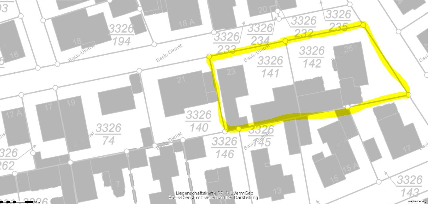

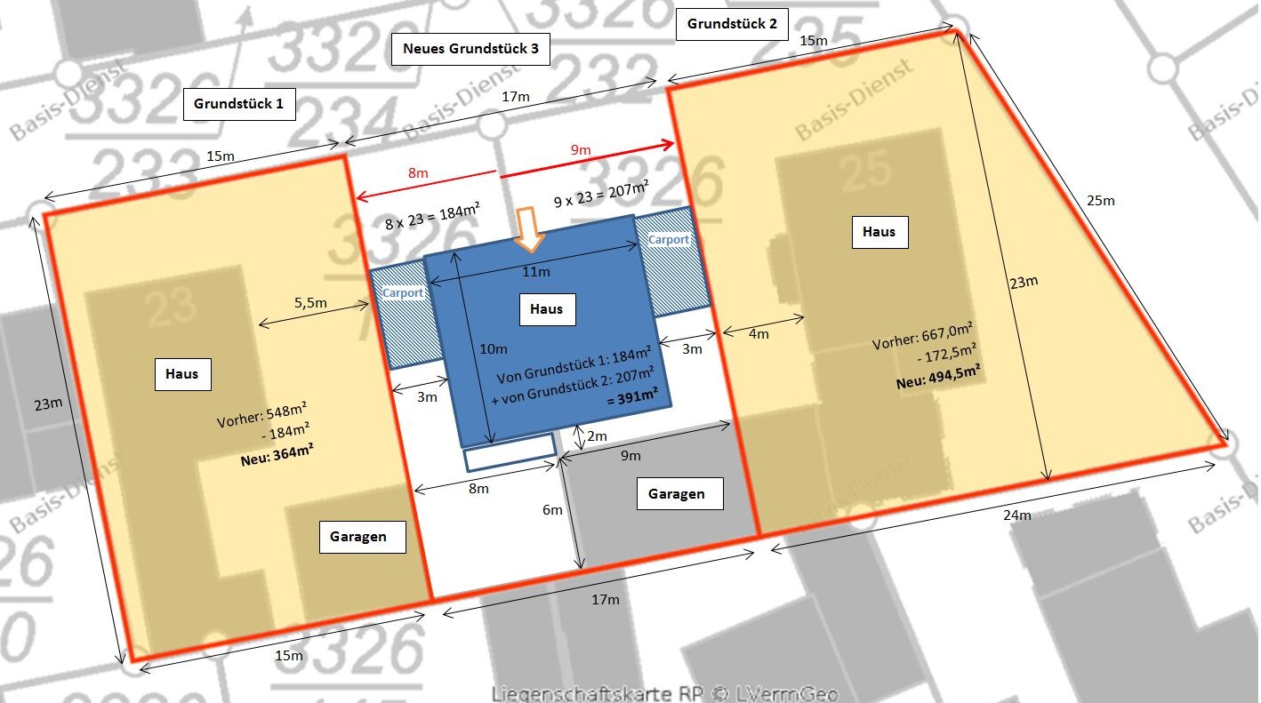

I want to divide two adjacent plots into three.
I would then like to build a single-family house on the third plot.
In the attached file, I have outlined my plans (current situation, division, development).
What is the best way to proceed, and in which order should I carry out the steps?

So, you’ve already taken the first steps. If you don’t want to rely solely on the statement from the authorities, submit a preliminary building inquiry; otherwise
Your planner will take care of the details, of course, you’ll need to involve them for the preliminary building inquiry or the demolition application. I think the project is too complex to cover all aspects fully in the forum.
Escroda schrieb:
Obtain the demolition permit. Then hire a licensed surveyor to handle the subdivision. Carry out the demolition, complete the subdivision, submit the building application, sell the plots, build the house, and move in.
