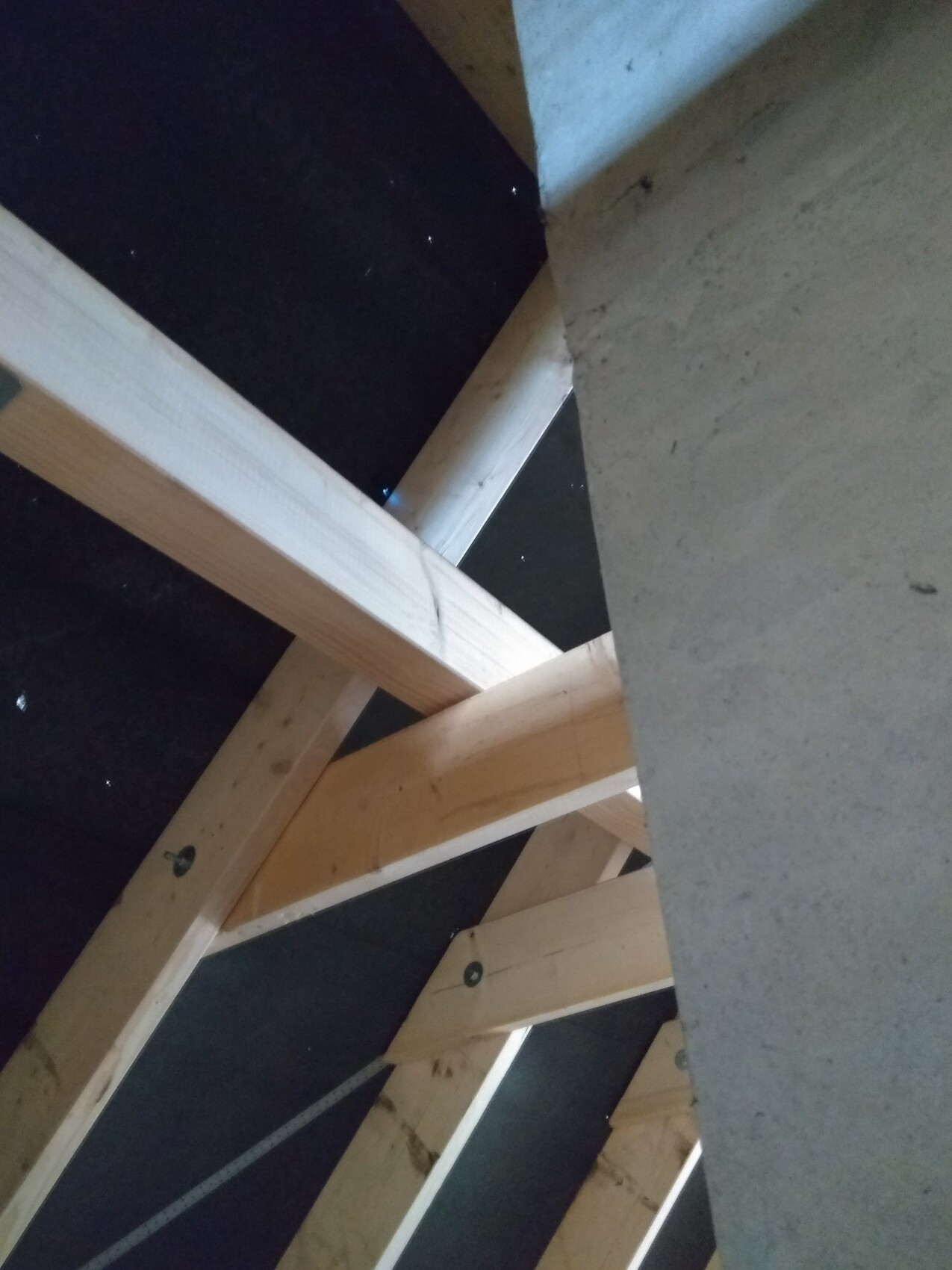

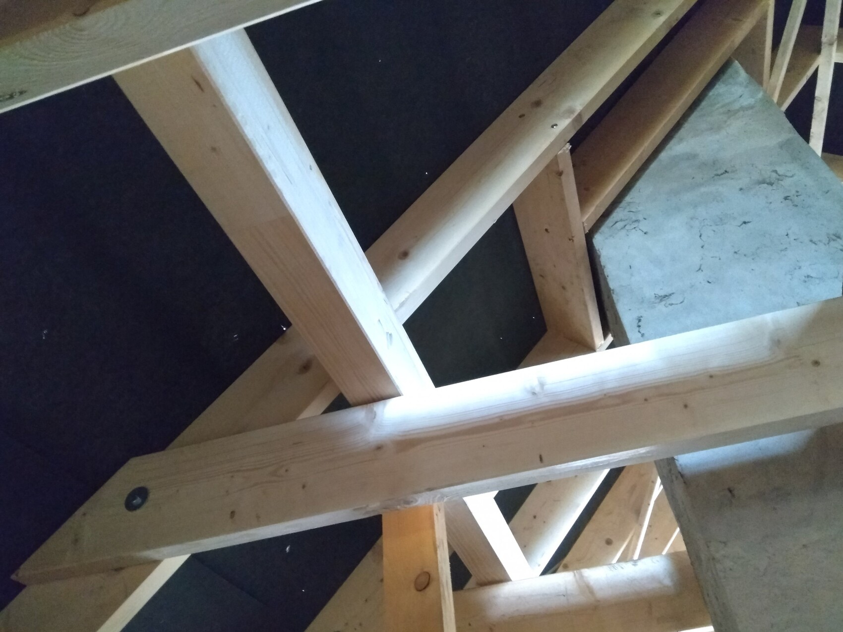

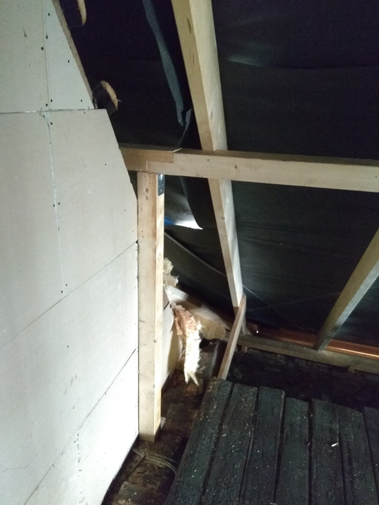

ᐅ The roofing underlay has small holes. Is this within the acceptable tolerance range?

Timber roof structure with rafters in the shell construction phase
View of a roof framework with wooden beams in the shell construction stage, visible roof structure.
Attic with wooden rafters, unfinished roof structure and insulation material

In my view, this is a defect. Such a membrane must also be overlapped and sealed to reliably function as a "second waterproof layer," meaning without leaks. How is that supposed to work with this number of holes?
Or is the metal roof 100% snowproof and rainproof?
andi9014 Jun 2018 23:50
At first glance, I would also say that this is a defect, as the holes appear to be quite large.
does02
15 Jun 2018 07:50
Holes must be sealed with appropriate tape. Please note that otherwise the warranty from the supplier of the underlay membrane will be voided.
