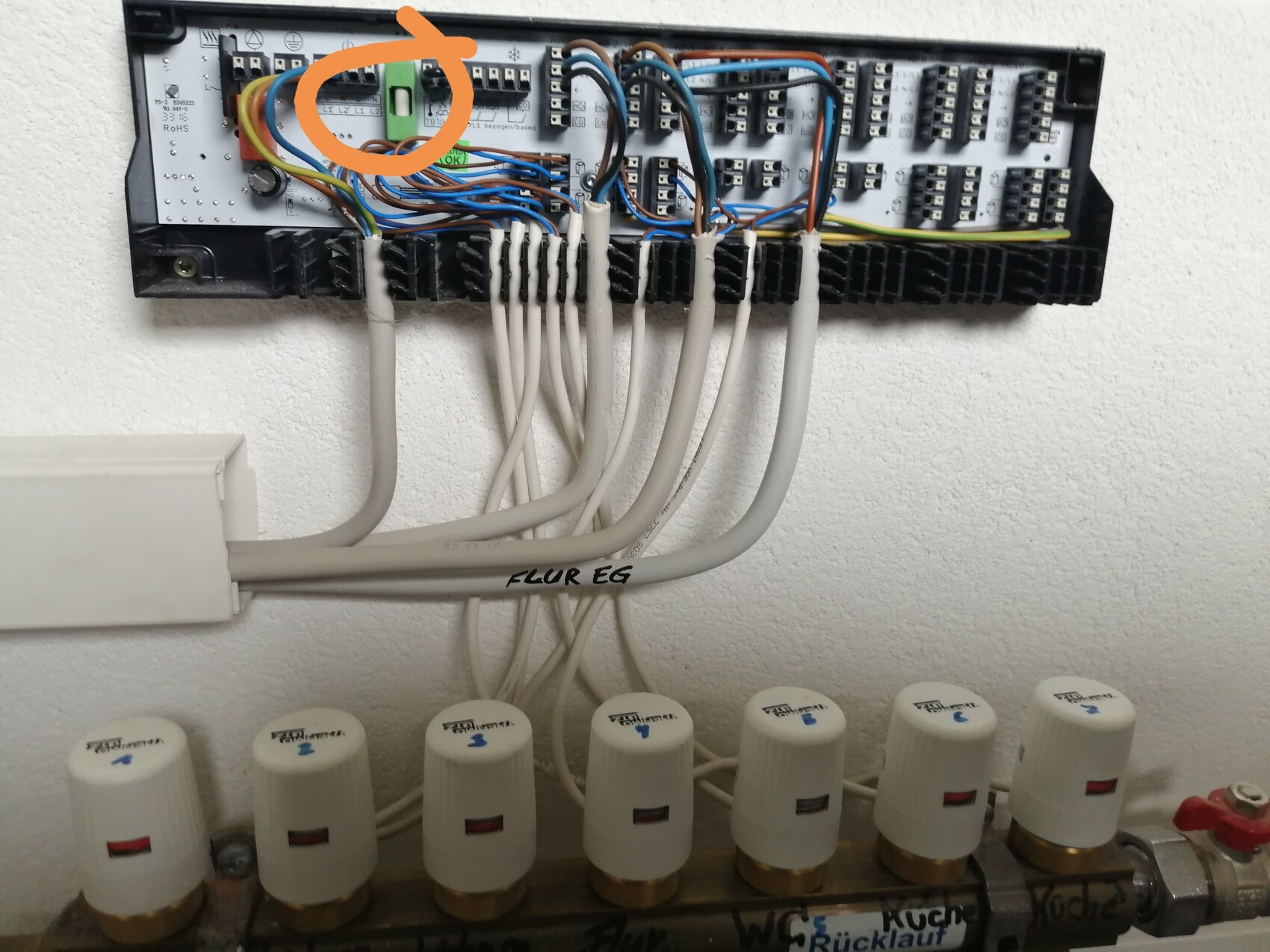

Hello, we need some help.
The underfloor heating on the first floor is no longer heating, but it still works in the ground floor and basement.
The pressure gauge shows 1.2 bar. The heating system was serviced at the beginning of the year. I suspect that our 5-year-old godchild might have adjusted some valves.
I noticed that when I turn the red valves in the ground floor to a vertical position, the supply pipe on the first floor gets warm, but that’s all.
Could it be that something is incorrectly adjusted?
See pictures.

Matthew03
29 Sep 2020 12:13
qwertzuiop schrieb:
Which one do you mean from the actuator?
Yes, the green one here on my end.
Electronic control panel with many colorful cables, heating valves, and thermostats below.
