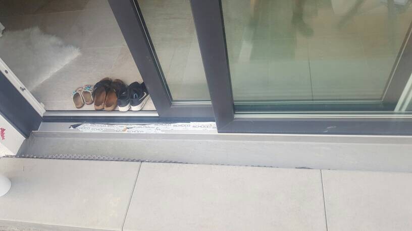

Do you have any ideas on how I could install a gutter there? Or are there any alternatives? Gutters are not exactly cheap either [emoji10].
Michael
Open glass sliding door at the entrance area with shoes in front and tiled floor

I can already see a gutter there. Maybe you could explain a bit more precisely what you want to achieve and what the current situation looks like.

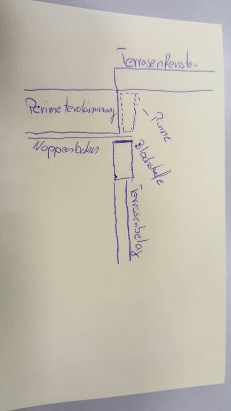

Attached is a sketch of the current state; however, a gutter is not yet installed.
Hand sketch of a floor plan with terrace window and door opening, rough lines
