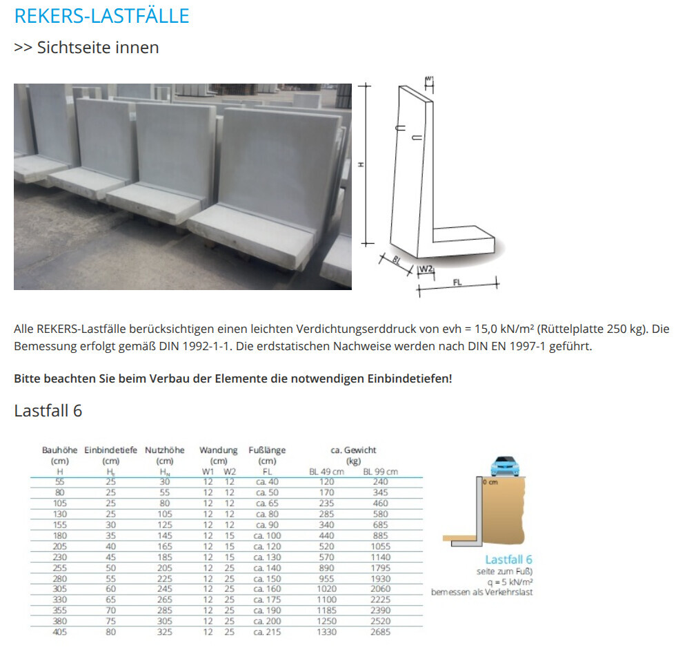

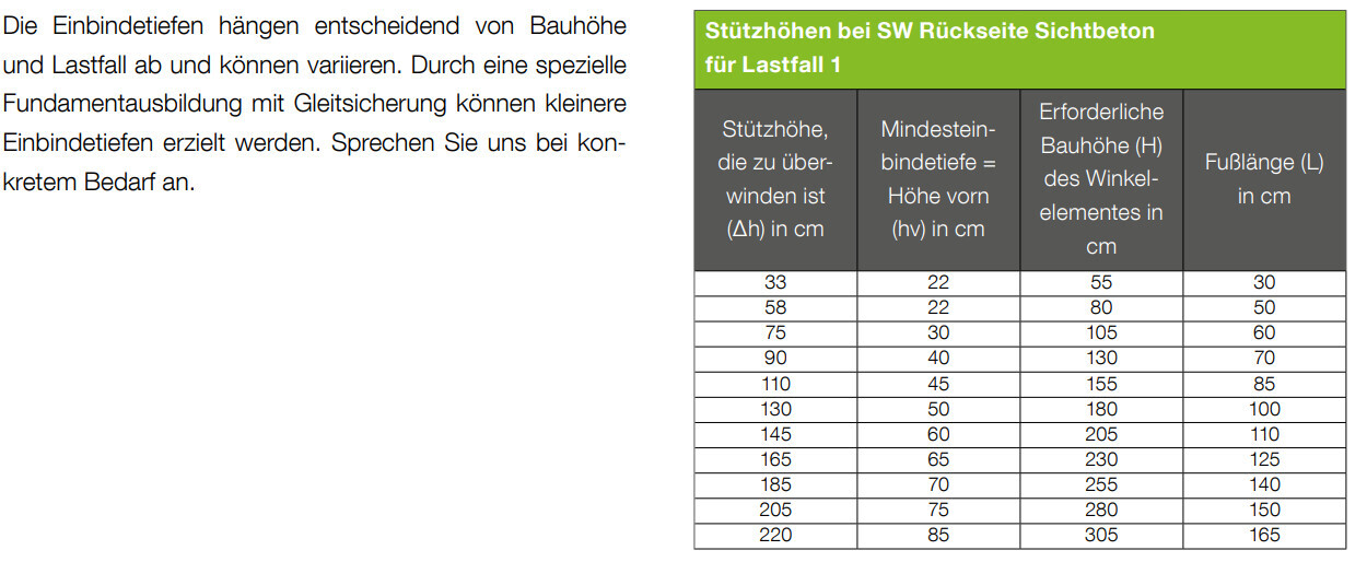

I understood what you mean, but these are not designed to support a slope. They are meant to face the attractive side toward you if you want to retain something on your side of the property.That’s not correct, see the post by @Tolentino
We are located downhill and had to retain the higher neighboring property. This was planned by the architect and approved by the building authority (building permit / planning permission).
And yes, they were significantly more expensive than the conventional L-shaped brackets.
