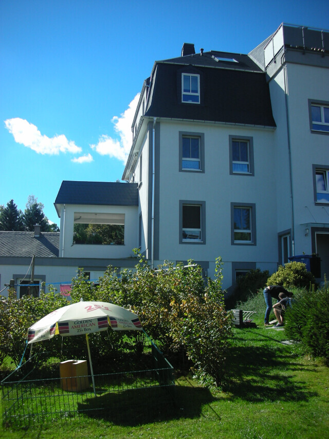

Even designing a gas boiler for 40 degrees is something from the year 2000...I can only confirm that. The old multi-family building here (350 sqm (3,767 sq ft) from 1913) was installed with gas, underfloor heating, and a supply temperature of just under 35°C (95°F) ... 12 years ago 😉. Additional wall insulation was applied only on the corners of the building facing north.D
Deliverer7 Mar 2022 19:18kbt09 schrieb:
Additional wall insulation only on the north-facing corners of the building.What does that look like, and how effective is it?D
Deliverer7 Mar 2022 20:15Ok... I can’t really imagine that this will have a significant impact on the heating load, but thanks for the picture.
No, I’m not thinking about the impact on the heating load, but rather temperature equalization, meaning the reduction of cold spots in the apartment. Also, the landlord was just here, and the back side visible here is overall also covered with a thin (about 60mm (2.4 inches)) layer of thermal insulation, since it faces north.
