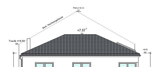

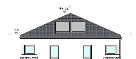

I think that achieving 10 kWp on our hipped roof with house dimensions of 11.30 x 8.30 m (37.1 x 27.2 ft) will be quite difficult. Or am I mistaken? A further challenge for good yield is that on the east side, the neighboring house is only 6 m (20 ft) away and is three stories high, so it will probably cast shade on the east side of the roof (see drawing). Or are my concerns unfounded?

You need to have it calculated.
knalltüte
4 Jul 2020 22:26
Download the Photovoltaic SOL 30-day trial version and virtually rebuild your house, including the neighbor’s house.
